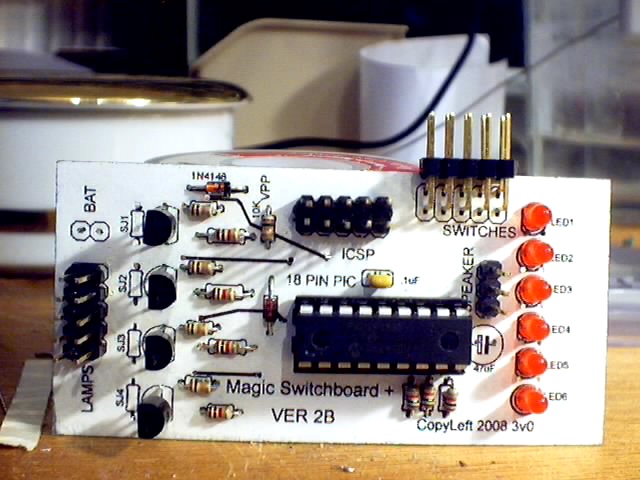

A little off topic but I want to talk about it anyway is that I have also in the past tried to make labels on the component side of my boards using the toner transfer paper and the white film. It comes out pretty good but if I spray paint over it, the white lettering turns light green. It's readable, but doesn't look good. I have also tried to put the labels on the board after spray painting but that was a mess becaue the heat from the laminator made the paint tacky again.
I have also tried actually silk screening the labels onto the PCB before using a kit from this site but it wasn't very EZ for me. Never got it to work right. I still haven't yet found an easy way to put white labels on the component side of a green PCB. :(

I have had good luck painting the top side of SS PCBs with Crylon Fushion paint intended for plastics. So far I have only tried white. The key is to use Pulsar paper to transfer the black lettering to the painted surface. Even if the laminator heats the paint the pulsar paper will release it when wet. Great stuff.
For boards that I am not going to reflow I use clear acrylic spray. Like another member said you can solder through it. Just use a thin coat. You can add to it after the board works if you want.

http:/picprojects.org.uk/projects/ir/sirc10f/sirc10c1.jpg
I keep the paper from Laser labels after the labels have been printed/used. This has a shiny finish to it that the laser toner releases from easily. I print a mirror image of the overlay onto this, then with a normal household clothes iron I 'iron' it on to the laminate. Only needs a very light rub over and the image transfers on to the PCB laminate.
Giving the board a quick rub with some fine sandpaper to help the toner key to the surface also helps.
Quick, simple and cheap.
Nice silkscreens geko and 3v0. I just really started putting some silkscreens on. Not so much for component placing, but labeling header pins on devel boards.
