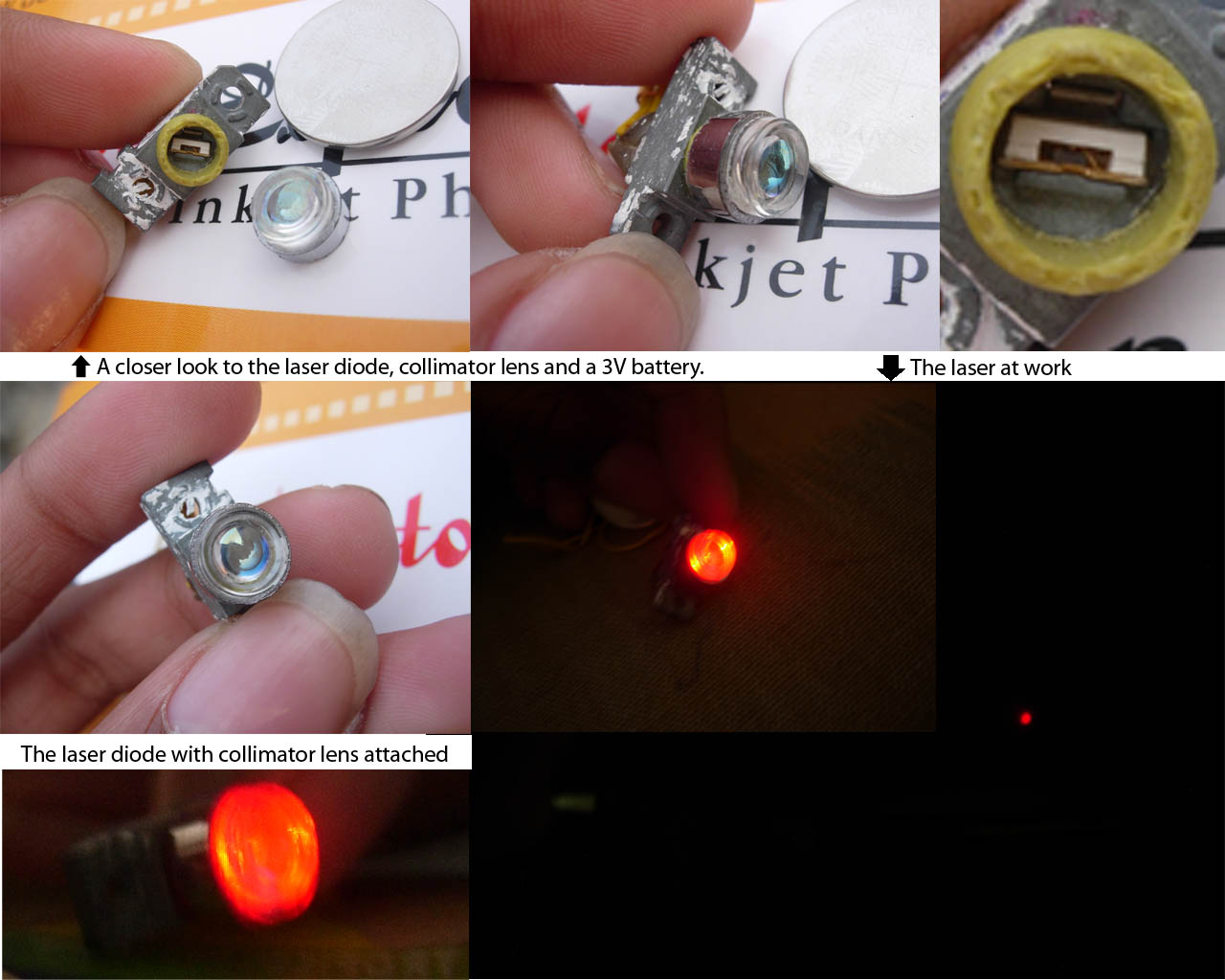

The laser that you see in the pic is a red one from DVD-ROM drive. It's not exactly powerful enough as I want.

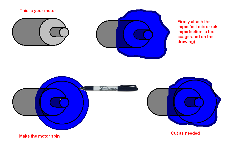

Haha no Slickit, just youtube videos I've favorited. What's your problem, alignement? A poorly aligned mirror will start to vibrate and then became airborne
With this method you can make perfectly round mirrors, and mark the exact central point (a very useful thing for you I guess)

My mirrors are round but since they are angled they start to vibrate pretty bad at high rpm's and in that video it looked like he had a very nice mirror in a metal case and it just looked very stable and reliable, not that mine arent but id like to stopo the vibrations.
Yes they may me round, but if not perfectly centred vibration will ocurr
Use the method I've shown
My laser diode at work.
I can see the focused point even at moderate light but cant see the beam even at 100% darkness. I didnt tried it at smoke.

You can't see the beam unless it hits something, doesn't matter how dark it is. To make the beam visible you need dust, mist or smoke for it to travel through.
oops!!it's a general properties of light. We cant see anything if light passes freely without a medium. Thats why mine not work. I'll try it with my father's cigarate smoke.
