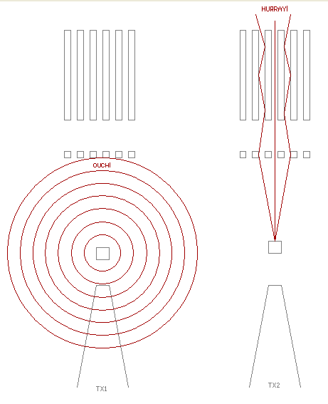

I would expect that a metal fence would use metal posts and be grounded.
I don't see that polarization would have any significant effect on the shielding unless the opening through the wires is significantly unsymmetrical.

Attached is a sketch of a completely unsymmetrical fence with transmitter waves hitting the fence. :D
