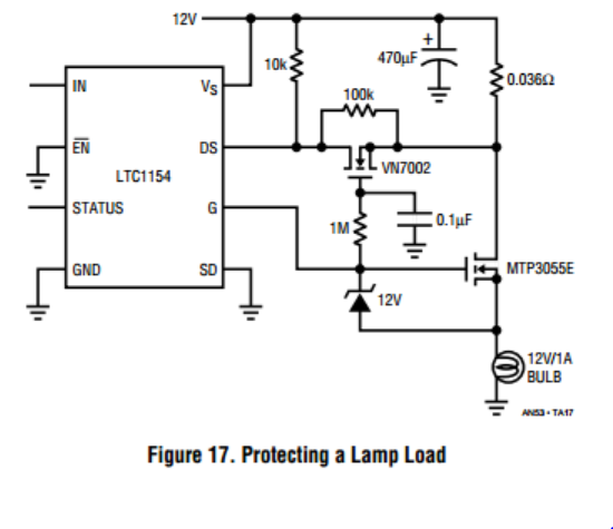

I am looking for a circuit that will allow one to hook a trailer to a modern car. Something similar to this unit from eTrailer. I would like to set this up on 2 or more cars so for $65 each I am willing to take a look at it.

I do not think I have PWM or multiplexed wiring. I expect the heart of this is 3 mosfets but am unsure of the short circuit protection. Maybe a resetable fuse for each of turn signal and running lights.

A polyswitch fuse on the negative return would protect against a bulb short, or a polyswitch on every line to protect everything.
The commercial units esp the ones that multiplex will probably use a microcontroller and a current sense resistor to measure the current, and shut down in the event of over current.
How complex do you want to go?
Originally I was going to use a microcontroller and I still may if I have the need.
I have the LTC1156 which does a lot of neat things including over current protection on order. AN53 has a lamp drive circuit, shown below, but uses 2 old hard to find fets. Need to check a cross ref.
I also need to grab a car tail ligh bulb and check the current.
I have used that series of high-side drivers and don't believe the mosfets are critical to the operation of the controller. The mosfets are both normal gate voltage. The main current carrier is the MTP3055 which is just a 12A/60V mosfet. I suspect anything similar or greater current will work. The VN7002 is just to provide a delay in voltage sensing (1M X 0.1uf on its gate). I couldn't find it quickly, but considering its role, any small mosfet with a 60V rating or so should work. A 2N7002 or 2N7000 might be a good replacement.

Yes the mtp3055 shouldnt be hard to replace, if its 1 or 2 amps then maybe an irf540 would be a good replacement, the fet will be on or off rather than operating in its linear region so dissipation shouldnt be an issue.
Stop lights usually pull a couple amps, and side lights 1/2 an amp.
That circuit looks overkill if your going to use a pic as well as the ltc chip, if you can stand a little more volts drop, like maybe 0.5v you could stick that straight into a pic's atod channel.
Edit: I just wired a 12v 5w auto bulb to my power supply, at 12v it pulls 450mA, and at 13.8 as on a vehicle with the engine running it pulls 490mA.
