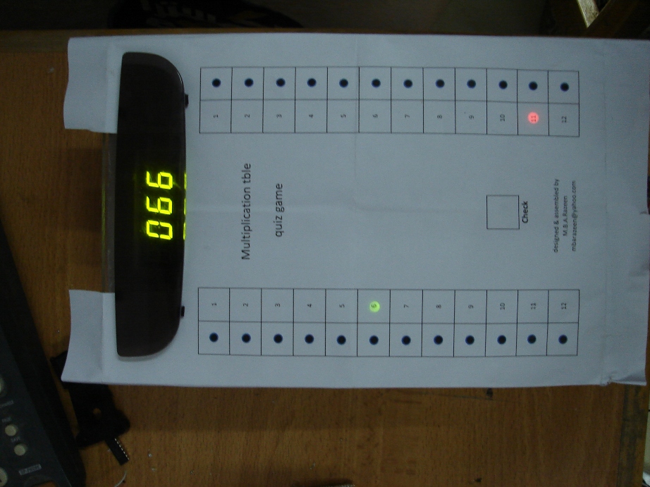

it will work, you have to hold the system when both counters become to zero simultaneously, the total clock pulses passed through during this period is the result A*B. so a third counter with display or anything will count the primary clocks till it gets a hold signal and the result can be displayed. i did such a multiplication table for 12x12 numbers only using counters & fundamental logic gates. see the attached snap.

Very nice. No schematic?
Hi again,
Oh ok good, or else scan it or take a good high res picture maybe.
