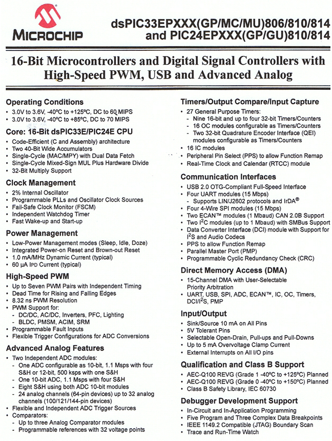

Things to consider , amount of code area and speed of mcu / communications , distance and noise , master / slave or polled . error detection . Personally my choice would be PIC24EP512GU810 70MIPS, 51 I/O keep it all in one micro.

Thanks for the interesting post. I think plus and minus for any robotic solutions, for sake of argument... focus on one task say an ultrasonic distance sensor handled by a remote slave mcu its program computes distance and waits for its master to ask for its data , it then sends " Edge of cliff 1 meters away" master tells motion motor to slow , motor slows. master checks task B, but task B takes some time to resolve , task C interrupts master a few seconds , task D interrupts master , master checks distance from cliff ........... oops .
Ok a bit simple and easy fix , just check sensors more often ... or have all the tasks given mcu time and / or priority interrupts on one chip....
Devise your own RTOS ...
