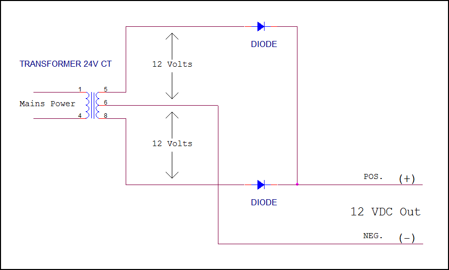

OK your transformer is exactly like the attached with 12 volts to each side of the CT. Using 2 diodes with a 12 - 0 - 12 transformer as attached you should be getting 12 VDC (filtering not drawn). It should not matter between 1N4000 series of the 6A4 diodes, The results should be the same in that you get about 12 VDC out.
<EDIT> Fixed image polarity, thanks Jim. :) </EDIT>
Ron

You may want to have a look at your attachment and review the +ve and -ve connections?
Ron
Thought it looked funny. Many thanks Jim. The image now has correct polarity designations. :)
