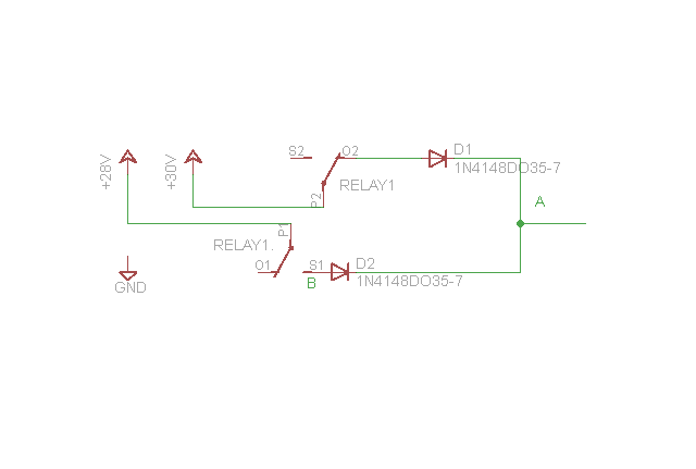

For the below circuit, I have placed multimeter +ve probe at 'B' wrt GND and measures 4V against the expected value of 0V.
Hence I have terminated the 'B' end with 10K to GND temporarily before taking the measurement and reads 0V.
Why this happens?

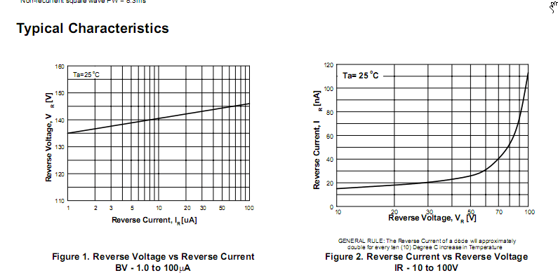

Check the reverse leakage current of the D2 diode and input impedance of your multimeter.

What happens to the anode of D2 while I connect a multimeter to 'B' end wrt GND ?
I have replaced the 10K temporary resistor with 1M, then again 4V measured !

When you connect the multimeter to point 'B' you are providing a path for the reverse leakage current of the diode to flow to 0V.
The leakage current will cause a voltage drop across the internal input resistance of your meter which will display as a voltage, its only nanoamps.

That is when I connect 1M resistor, V=IR-- a considerable drop occurs and reads as 4V.
In the case of 10K, measures very low as nA * KOhm and will be in MicroVolt range approximately 0V.
Am I right ?
