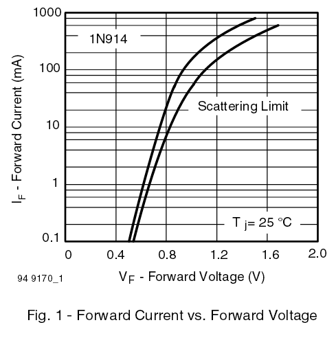

1N914 is a silicon diode and according to the book the forward voltage is 0.7 V. But from Multisim it looks like to be 0.594 V, is this what you would expect?

It is within the normally expected range of values for this kind of diode. The instantaneous forward voltage drop in a diode depends on the specific diode junction construction, temperature, current, etc. The sim program opinion of the diode's Vf is just that, an opinion. Always remember that test equipment, simulation software, and other analysis/diagnosis tools *never* show you reality; they show you the tool designer's opinion of reality.

The forward voltage is dependent on current and temperature. (and what type of diode)
You have 10 volts and 10k so about 1mA.
Look at the graph. 1mA=0.6 to 0.65 (hard to see but some thing like that)
It's a bit difficult to read the x-axis, I used Plotdigitizer (http://sourceforge.net/projects/plotdigitizer/files/plotdigitizer/2.6.6/) and constructed the graph below. Why are there two curves, one hits x-axis at 0.5 (blue curve) and the other (red curve) at 0.54?
