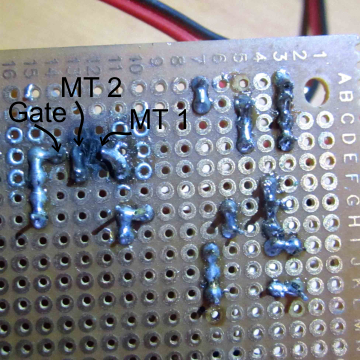

Hello you guys, thank you for accepting me here, right now I'm making a tool to dry the plastic filament, the unfinished part is the dimmer with a triac because MT 1 and MT 2 are on fire, like this has happened for the third time, then the input section exploded three times that caused the electricity at my house went out.
But this circuit works if I use breadboard but not veroboard, and this dimmer I combine with 555 timer IC (circuit diagram in figure 3 and figure 4b, https://www.nutsvolts.com/magazine/article/using-the-555-timer-ic-in-special-or-unusual-circuits). I do not know what caused it, hope you guys help me, thanks.

I can't but help wonder if (a) there was residual flux between the solder joints, and (b) if the insulating distance between the veroboard is (much) less the breadboard (ie., the breadboard is providing more insulation between the joints than the veroboard). IIRC, the minimum spacing between opposite 240VAC traces is 6mm (.23 inches) or skipping 2 veroboard boards where the copper rings have been removed (as they will negate the insulating airgap).

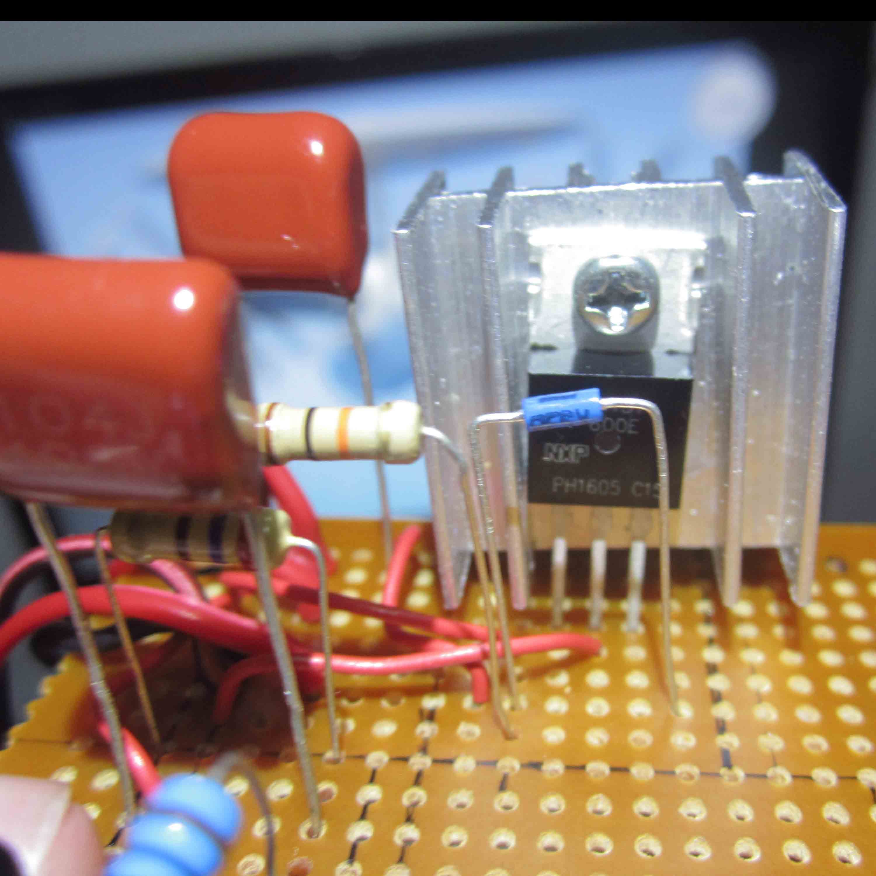

If I've read the datasheet for the BT137 correctly, that heatsink should be isolated ?

Breadboard nor veroboard are really suitable for prototyping mains power.

As a first step then , Heri, it would be interesting to try the dimmer with a different load - an incandescent/filament light bulb of 40W or so if you have one.
In fact, we should check that the circuit is ok with no load at all - just in case there is a wiring mistake.

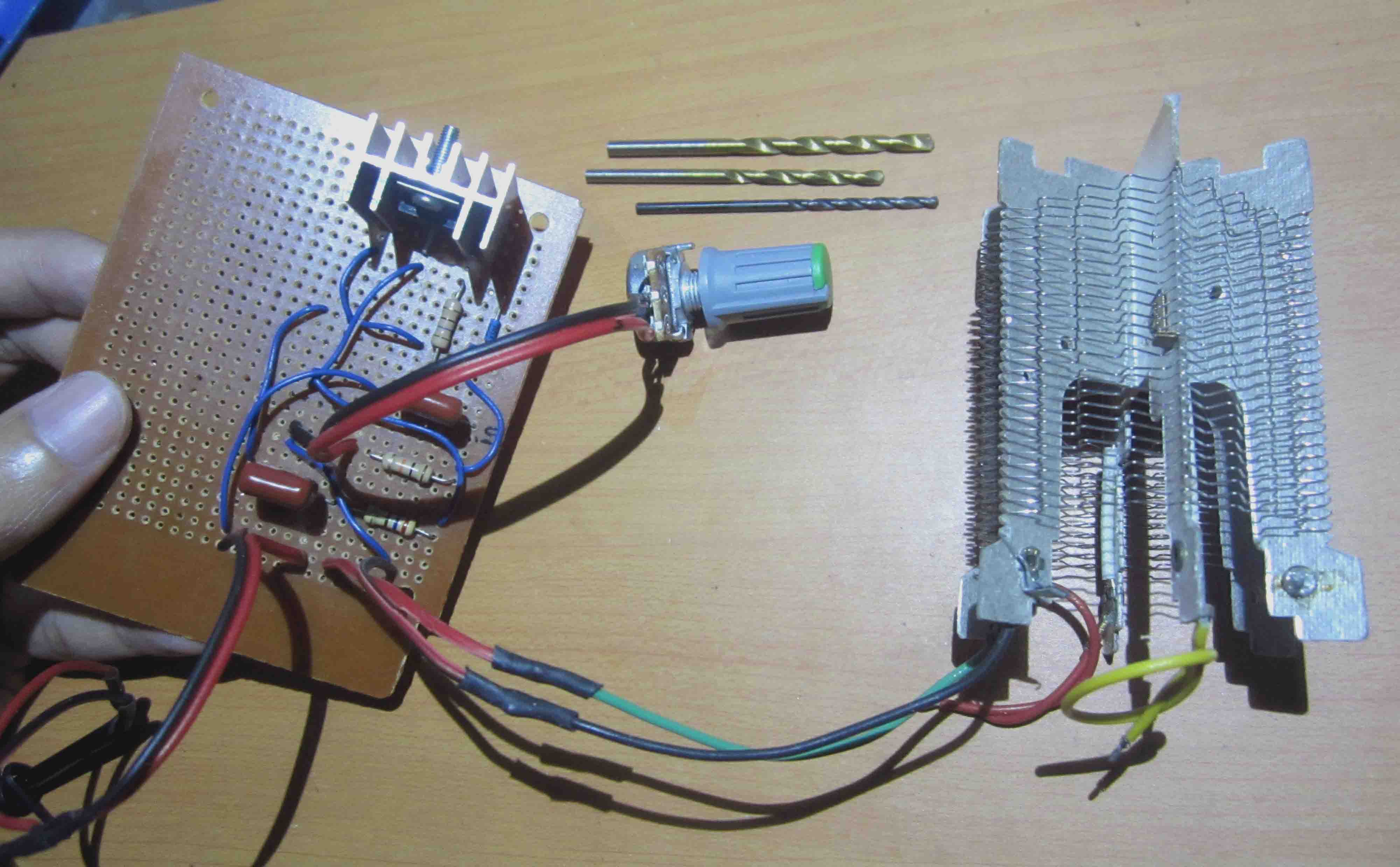

I agree that this type of varoboard is not the proper thing for permanent mains circuits, but it should work for prototyping something like that.

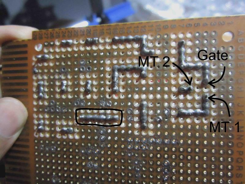

I'm sure with the main power because I can use this circuit in breadboard. From this forum I got words like airgap and isolated, then also in other forums also similar like creepage distance, they suggested to bend MT2 forward of triac and removing un-needed pads in the high voltage area but i did it around the place . By temporarily trying this circuit once and the result does not emit a fire.

because it will be on for at least 4 hours.

I'm not sure I agree with this, as long as the proper steps and verifications are made.
From a purely materials stand point the circuit board material is the same between the veroboard and etched PWB and copper is copper.
Two items that need to be considered are: voltage clearances and current capacity.
1. Since the modification and picture in post 19 works, that empirically shows the issue was likely related to arching and clearance required for 220VAC was not met for post #1. The adjacent pads and unused pads of the original layout resulted in a violation of the clearances for 220V circuit.
2. The current capacity will be the next item to consider, track width and copper thickness dictate the current capacity. Copper width and thickness can be specified in order to meet the current requirements when having a PWB etched. The same is not the case for veroboard. What is the copper thickness (listed on the package) and trace width (likely have to measure) and does it meet the requirements? As shown in the picture in post #19, all connections have considerable solder which should allow for a few amps of capacity (as compared to 0.5 to 2 oz copper trace of the same width).
