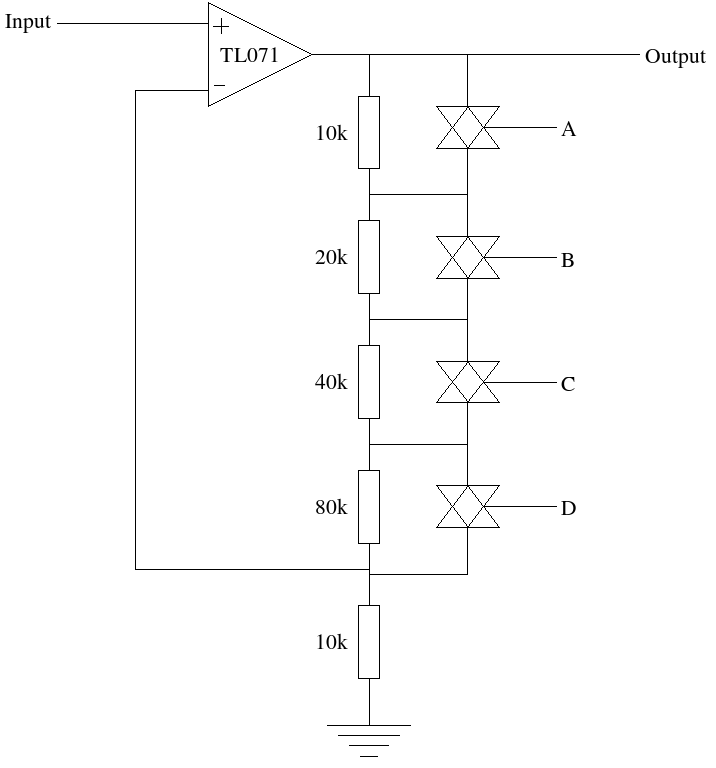

This is how I would do it, use a CMOS analogue switchs like the 74HC4066 to short across resistors in the feedback loop of an op-amp.
The example shown belowwill give gains between 1 and 16, you could easilly add 160k, 320k, 640k and 1M28 resistors and another analogue switch IC to give a gain between 1 and 256. I wouldn't go over 8 bits per op-amp as the feedback resistors start to get prohibitively high. If I wanted 16 bits of resolution to go from 1 to 65536 then I'd connect two of these amplifiers together.
hi hero999
Did you build this before, is it work ?, I got interest to build this one .I have this 4066,lm74193 to control 4066,lm741.

No, I haven't built it before but it should work and don't use the LM741, it's rubbish.
