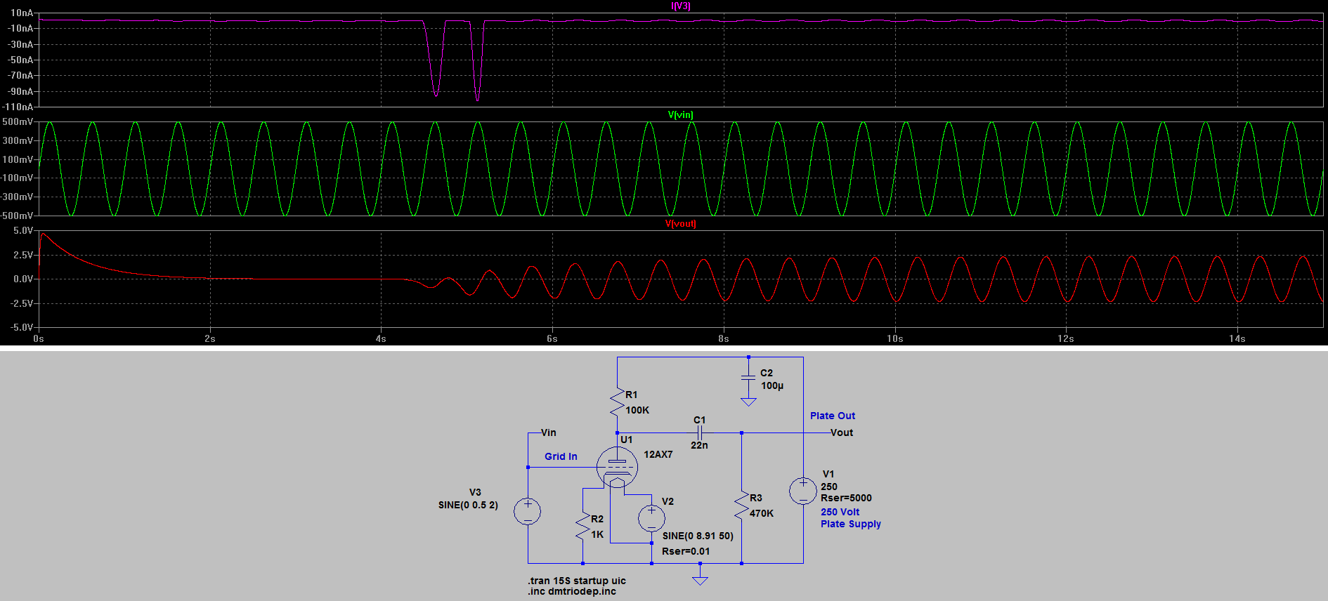

One more time, the only difference between an analog tube tester and a new super duper digital tube tester is the display. There are analog tube testers that also have 400 volt and higher B+ plate supplies. The term "Digital" as it applies to a tube tester is no more than a marketing term.
Typical grid current in a triode vacuum tube is very low as in tiny as in nano amps. During normal operation as a tube functions, with a focus on a basic Triode tube, when energy in some form is applied to the cathode (heat energy) electrons are released or as some say cooked off. There are several methods used to heat the cathode (filaments) and we won't get into them. The cathode is a thin metal sleeve coated with electron emitting material such as alkaline earth oxides. The cathode, again, is heated by the filament. Over the life of the tube tiny micro particles of the cathode coating get emitted with electrons and smash into the grid. While over simplified this is what happens especially when tubes are pushed beyond their normal operating limits. When this happens the normally tiny grid current begins to increase. Grid leak current is inherent to the normal operation of the tube, only when this normally tiny current increases because of chunk emission of cathode particles does problems begin. If you want to test for excessive grid leakage then look at the grid current. Personally I believe the following quote to be true as stated.
Grid leakage is also a term that is frequently incorrectly used to describe the condition of a tube when tested on a tube tester. The correct term is inter-electrode leakage, which refers to leakage paths between the elements of a tube. Many emission type tube testers have leakage tests that far exceed the application of the tube being tested and will reject many perfectly functional tubes. Sencore sold tube testers in the 1960s that were claimed to have the "most sensitive leakage test in the industry".
As to life test? If you were to look at a schematic of most tube testers that have a life test button you would find that most simply reduce the filament voltage by about 10%. They do this by using a button switch to place a power resistor in series with the filament voltage lines. So a 6.3 volt filament now only sees 5.67 volts and a 12.6 volt filament now only sees 11.34 volts. The theory here is a good healthy tube should not drop below 90% of its operating characteristics. Personally I see this as more hype than anything else but if people choose to see useful information in this form of life test, then cool with me. So as to the cathode in a life test? Normally a cathode is heated to around 1050 Degrees K. Now obviously if we reduce the filament voltage 10% the cathode will run at a lower temperature. The question is running at a lower temperature how well will the cathode emit electrons?
The true test of grid leak current of life test is how well a tube is functioning in a circuit it was designed to function in? This is why most savvy engineers and technicians prefer to actually look at a tube in circuit using good equipment to evaluate the tube performance.
The attached below image should give an idea of what is going on. The purple trace I[V3} is the grid current, note it spikes as the tube goes into conduction. The Green trace is Vin and the Red trace is Vout. Vout starts to grow in amplitude as the filament heats the tube cathode up and it begins cooking off electrons. Conduction begins just beyond 4 seconds.
