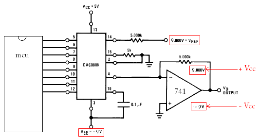

Post a schematic.
You are running the 741 on split supplies, at least +-10V, right?
You are tying the non-inverting input of the 741 to 0V?

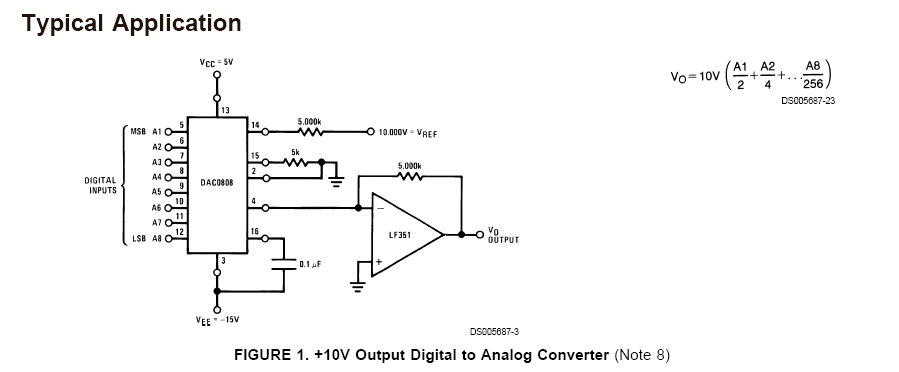

Yours should look like this, taken from the **broken link removed**

Hi there,
I've attached the schematic down below.I could really use your advice on this 'cause it's the first time I use this IC.
thx a lot in advance.
regards.

In order to invert the DAC signal output from 0 > -4.9V to say 0 > +5V you require a inverting OPA with the gain set to just over unity.
Use the OPA circuit as shown in the application data for the DAC.

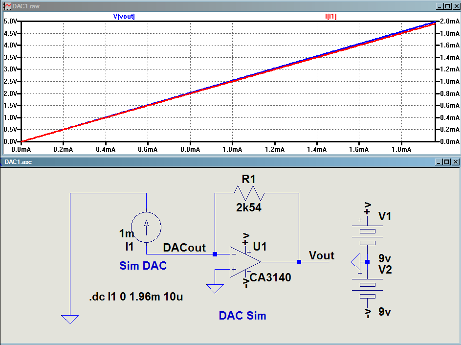

Look at this LTspice simulation.
EDIT:
As you require a +5Voutput use the lower value of feedback resistor as shown the simulation.

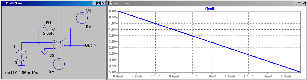

Eric, the DAC sources current, so the op amp needs a negative supply, and the output of the opamp will range from 0V to -xV, where x depends on the feedback resistor.

Just turn the current source over in the LTSpice sim.

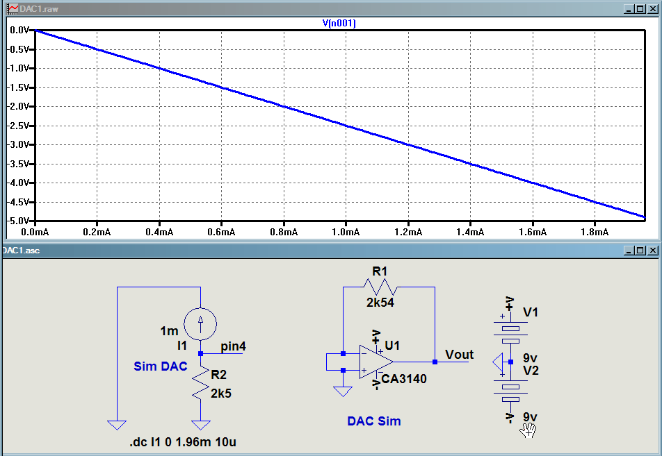

Modified the sim to show the Vout as a result of 0mA to -1.991mA using a 2k5 load as per the DAC datasheet with current source direction same as shown DAC1.gif [post #11], no change made to current source direction.
The plot corresponds to the datasheet description.
You also said in your earlier post that the OPA requires a -V supply, which it has already.????

Yes, but I think this sim better reflects how the OpAmp converts the current sourced by the DAC into a negative voltage at the output of the OpAmp. The point I was trying to make to the OP is that the OpAmp must be powered from a supply that is more negative (how much depends on the OpAmp) than the expected negative output voltage.

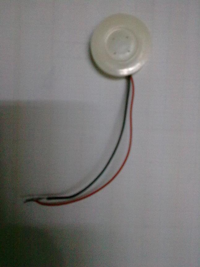

thx for your valuable contributions. Now the reason I was building the D/A converter is that I want to:
1- A/D convert audio from a microphone
2- D/A convert the result to obtain the audio back
I got a microphone but I don't know what's its impedence (didn't buy it myself!) I attached a picture of it and on the back the microphone reads:"Wellix DR-08" and I'm confused about a couple of things:
- How to test it?
- How to determine the appropriate gain for a corresponding amplifier? If I want the audio to be in the range 0 -> 5V for instance?
I really need pointers on this 'cause it's the first time I try this sort of thing! (A/D then D/A audio!!)
Your precious information and advice are greatly appreciated gentlemen!
thx very very much in advance.
regards.

Ok, I just went and re-read the DAC0808 data sheet, and I see that I was mistaken as to the direction that the output current flows at the IO pin. It flows INTO the pin; not OUT OF the pin as I previously was thinking... This means that the output of the 741 OpAmp never swings below 0V.
