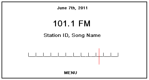

Alright, what I should probably do first is get a color LCD working. Does anyone know of a good website to find nice color LCDs that aren't extremely expensive?
I was thinking of the design looking similar to this:
I will, of course, have varying colors. But you get the idea.
Austin

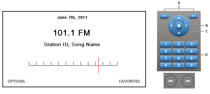

Menu Configuration
Hello,
I composed an outline of the menu I will have. It is still a tentative list, since I will most likely think of features I'd like to add in the future.
OPTIONS:
• Mute
• Receive Signal Quality (RSQ) of current channel
MENU:
• Receiver Settings
• Favorite Stations
• Time/Date
Note: Menu is initiated by pressing the center button (B in the example diagram).
Menu Configurations
Hello,
Since I couldn't edit the other menu configurations (it won't let me go into advanced for some peculiar reason) I am posting the latest revision.
