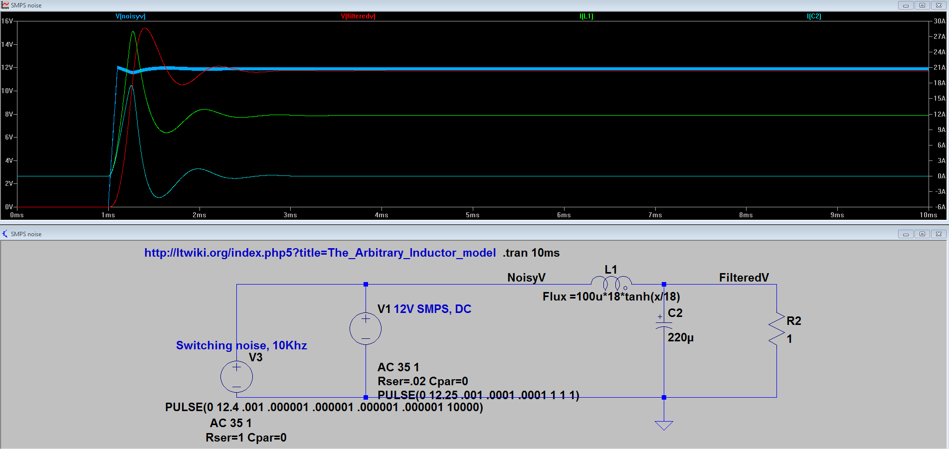

I did a sim in LTspice with a .02 ohm impedance DC supply and an overlaid 1 ohm impedance, 0.4V, noise signal @ 10Khz into a 1 ohm load for about a 12A draw. Using a simple LC filter with the 4 parallel Jameco toroids (net .018 ohm series resistance) and a .04 ohm ESR, 220uF average electrolytic capacitor you realize a 3db attenuation starting at 1Khz. https://circuitcalculator.com/lcfilter.htm
The light blue trace shows the power up from 0V @ 1 millisec and the superimposed 10Khz 'noise' = thick line.
The red trace is the filtered V after the LC filter. Note it settles at 3ms and is quite clean.
The green shows the current through the inductor and the teal trace is the current flowing in the capacitor. You can see the startup current surge into the cap is almost 18Amps. The Flux eq for the inductor simulates saturation @ 18Amps load.
