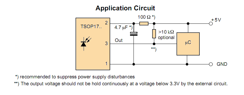

we can get digital signals from it ?
can u name one ?
using opamp, is it reliable ?

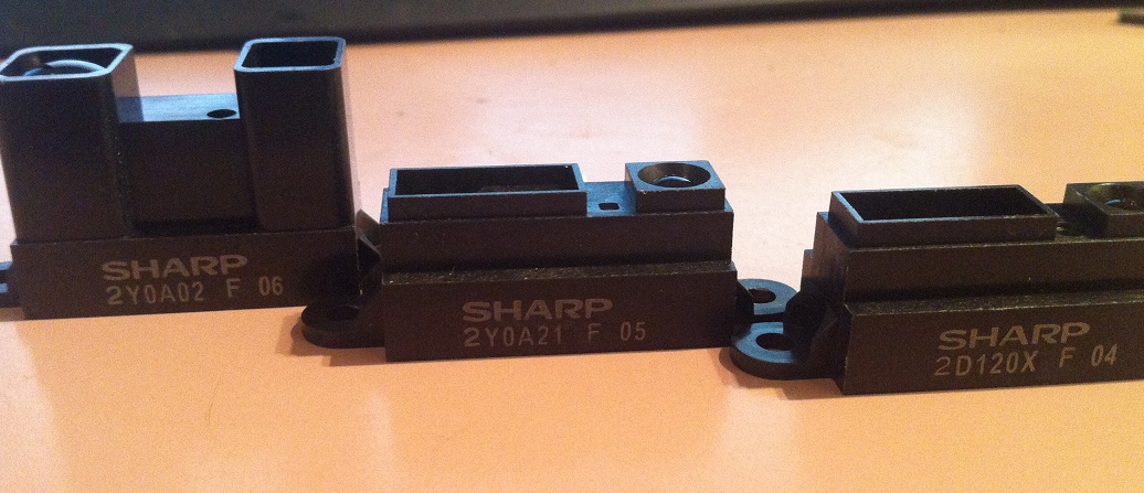

You can get a much better, adjustable range if you use a (more expensive) Sharp IR sensor connected to the comparator input of your microcontroller, with the internal, adjustable Vref.
Sharp IR sensors use triangulation instead of intensity to measure the distance which makes them a lot less affected by the surface and colour of the object measured as well as sunlight/fluoro lights.
Here's some model numbers to google:

The emitter and detector are the problem in that circuit, in that the emitter output is continuous, ie: DC driven.
The detector will detect ambient light as well as the IR light from the emitter, so if the ambient light changes, the signal input to the LM358 will also change.
This is why most emitters are pulsed rapidly on/off , an AC signal.
As the detector is also AC coupled, it can be designed to only respond to the AC signal and not the ambient light,, this is what the TSOP17xx detector modules are designed to do.
can anyone point me towards a working tsop1738 to work with microcontroller,
is the programming while using tsop1738, is like a switch, or there be complex programming ?
Hi varunme maybe you want something **broken link removed**
You have already got a link to a working version of a TSOP system in Post #9
