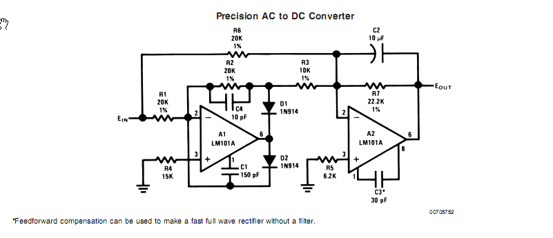

Look at this image for a precision rectifier circuit.
I would consider using some form of mains isolation for the 240Vac to 5Vac circuit.
Either a small transformer or an opto coupler.:)
