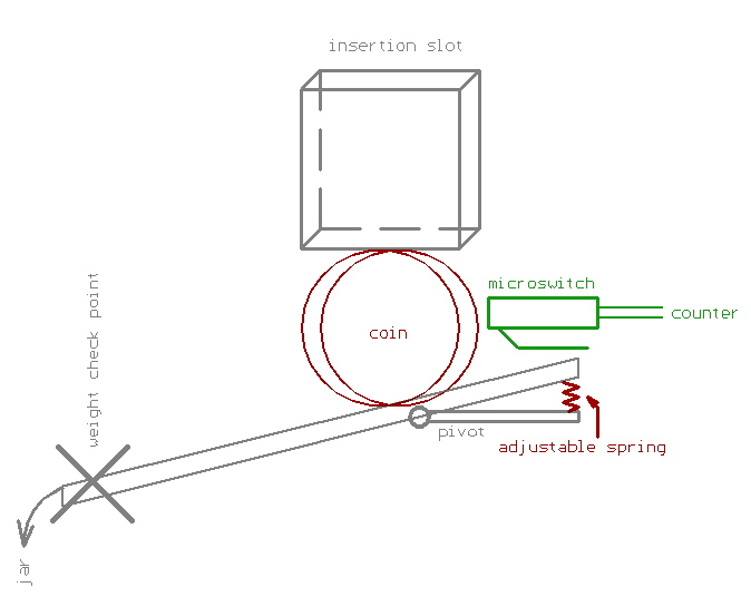

The project I am working on now includes my other hobby of wood working. I am in the middle of building a realy nice money box. However I want to add some electronics to the whole project to make it that much more special.
The box I have will be for $1 canadian coins only. I would like to install a digital LCD counter under the lid and coin slot. I would like for there to be a total count of how many coins are in the box. The LCD will be installed into the lid for display.

Does it have to reject other coins?
If not a pair of contacts could be used to trigger the counter, it could be as simple as a a couple of PCB traces which become connected when the coin slides across them.

If you want reliability use an IR transistor/led combo. The coin may bounce on the PCB traces and register 2 or may not connect at all.
Hi ruggerbugger,
counting coins you certainly don't want the circuit to count anything tossed into the jar.
Here's a mimic limiting cheat counts effectively. The insertion slot must not be larger than the coins to put in.
Buttons might have an allowable size but fail having the correct weight.
The inserted coin rolls downslope and if the weight corresponds with the real value it triggers the counter.
You might want to know how many dummy coins you collected. Use a second counter based on an IR-barrier and count everything being dropped into the jar. Subtract the "real" counts from the total count to know if the money suffices to throw a party. :D

Thanks for the responces guys.
Boncuk, I like your idea a lot. I am going to plan yours and Mikes. It will just be myself and the wife putting the coins in. This money box is a little motivation for quiting smoking. No buttons or crayons will make it in, lol.
