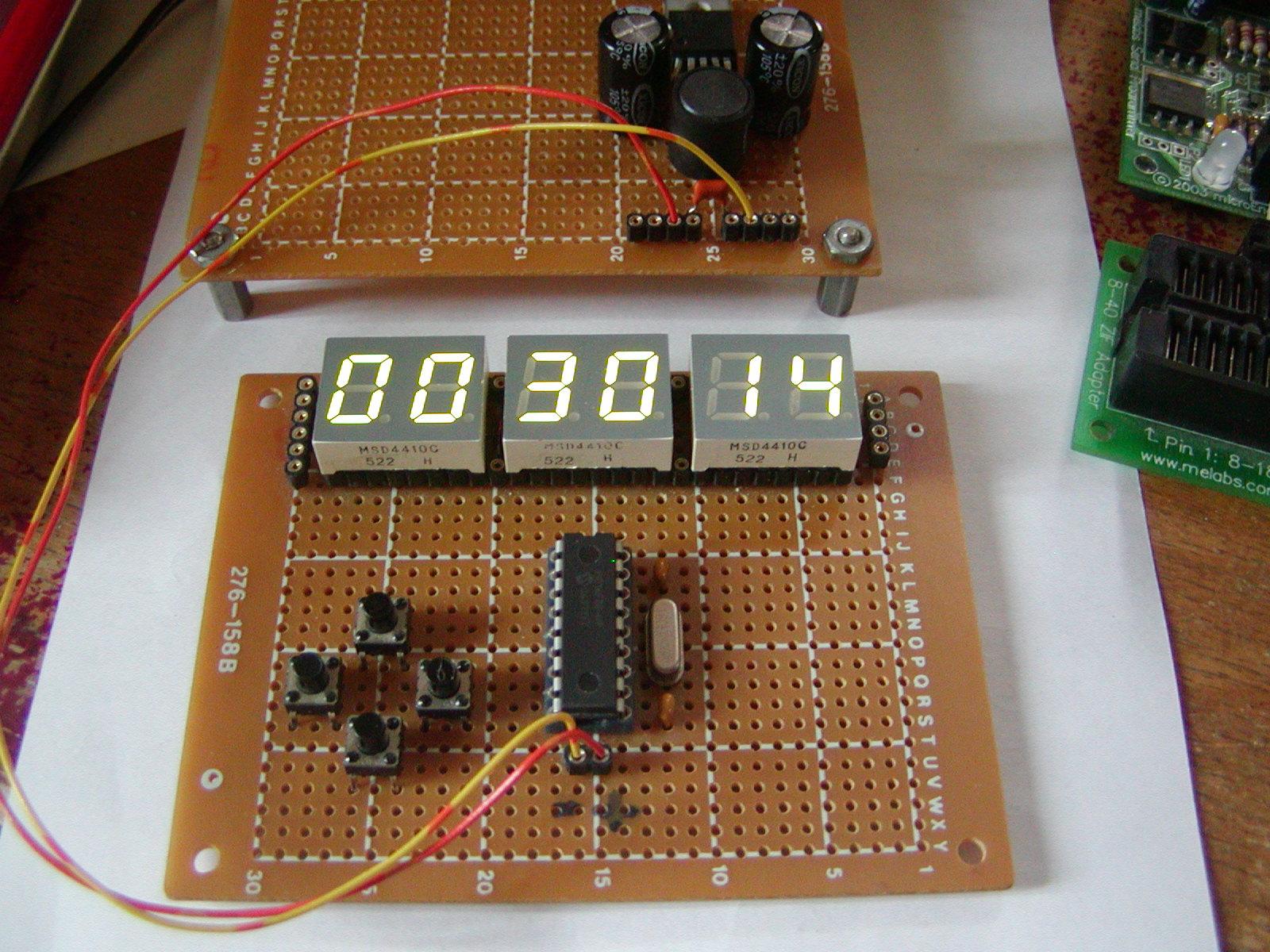

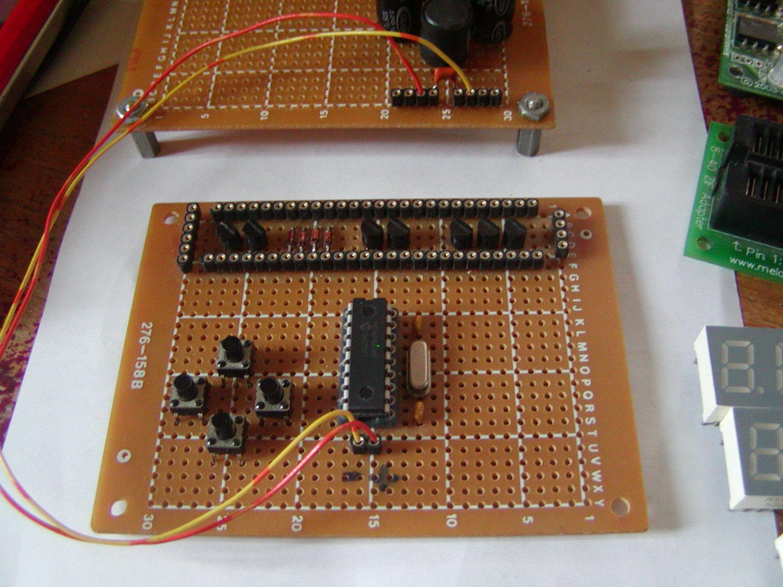

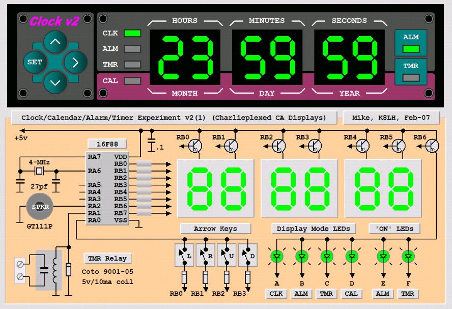

If you're interested, I hope to post a single chip Charlieplexed Clock based on the experiment below in the Projects sub-forum this weekend.
The first installment is just the Clock portion of the experiment below and the source is written using the free/lite version of BoostC. Features include;
<> run and set modes (a display 'group' flashes at 2 Hz in set mode)
<> switch debouce (press and release states)
<> switch press beep feedback
Subsequent installments will include the Calendar, Alarm, and (appliance) Timer functions using the same base hardware (PIC, six digit display, four switches, etc.) as I finish moving the code over from assembly language to C.
Please note that the drawing is misleading in that the displays are wired in a Charlieplexed matrix even though the drawing suggests they're wired as a standard multiplexed matrix. I'm working on a new drawing.
Regards, Mike
Regards, Mike
hey mike, can u pls explain the workin of this clock?
is that the one thats misleading?? finally, looks like a simple enough clock to build, eagerly awaiting a reply..
It's the Charlieplexed display wiring that's misleading in that schematic. I've attached a display wiring detail (below). A Charlieplexed matrix uses a "floating" segment line which means you can't use standard multiplexed 2-digit, 3-digit, or 4-digit displays. I used non-multiplexed 2-digit displays in this project which means there's a lot more wiring to be done.
A clock is a clock, is a clock, is a clock (grin). They all work the same. I'll attach working BoostC code if you want to take a peek at the program but I still have to add repeat capability for the up and down arrow keys. Again, I hope to post a better schematic and final code for a plain vanilla Clock in the Projects forum this coming weekend.
Regards, Mike
