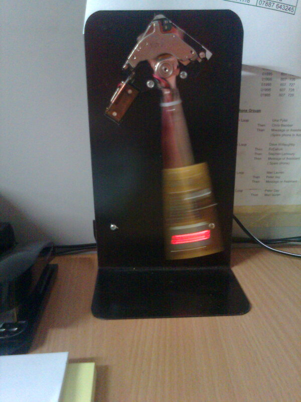

Not the best picture but this is a pendulum clock I built the other year from a dead hard drive servo mech, the display is on the pendulum weight, it uses a 32khz xtal in conjunction with timer 1, the code for it is easy and the clock maintains 3 seconds a week without any adjustment.
Not much more I can do for you though the code for this is asm.
