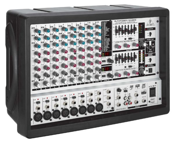

What sort of power are you looking for?, I'm VERY :lol: :lol: HAPPY with my Behringer mixer amplifier, 400W per channel stereo for only £216.99 from https://www.bluearan.co.uk/. It's class D and switchmode PSU, so it's very small and light (for 800W).
Cool, that looks nice :D , very compact for that sort of power yeah.
