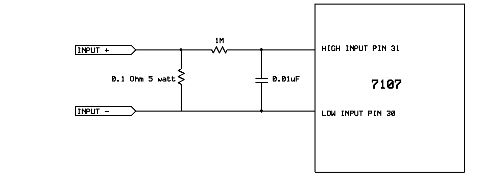

I'm after a circuit (easy!) that I can build for my car to measure current. I have a 7107 A-D, and wondering if anyone has a circuit diagram I could use? I'd like to use single-digit 7-segs.

Check out this link for the general 7107 wiring.
https://electronics-lab.com/projects/test/014/index.html
As you know, this link provides wiring for a voltmeter. To measure current use these component values for the pins 30 and 31 of the 7107.
Source: "Build Your Own Test Equipment" by Carl J. Berguist.
This will give you a 2 amp scale.

Will that current sense circuit work for a regular microcontroller with an ADC as well? I'd like to measure current in a car application as well, and I'd like to use a microcontroller.

Yes, it works just the same, but you have to be careful with the grounding arrangements - the circuit shown uses a totally seperate power supply to that of the circuit being measured. You should preferably do the same with a microcontroller, otherwise you need to arrange the circuit for it not to matter (which may not be easy!).
very good point. I realise that I should have pointed that out. Thank you. :)
Also, the resistor is 5 watt, because 5 watt resistors are easier to find. A 2-3 watt resistor would work here just the same.

I suspect car currents would be a lot higher than 2A (judging from my fusebox at any rate). What component values would I use / how would I get the 7107 to handle higher loads? I'm guessing up to 20A would be ok to display.

See page 53 of the September 2003 the Australian magazine "Silicon Chip"
The article is entitled "Current clamp adapter for multimeters" it uses a Hall Effect device inside a clamp that is placed over the wire to be measured (ie. no electrical connection is necessary) and they claim it can be used for up to 150 Amp for DC and 630 Amp for AC (with a -3dB point at 20kHz)
The output is connected to a normal digital multimeter.

Ignition current should be relatively low, but starter motor currents are massive - 150A would be fairly usual!. If you're wanting to measure the total battery current, an easy way, without modifying the car in any way, is to use an opamp as a differential amplifier to measure the voltage drop across the earth lead from the battery to chassis.

Yes, you could do it with a panel meter, but this would require you to break the circuit and inset a shunt. Whereas, the SC design simply clamps around the cable.
