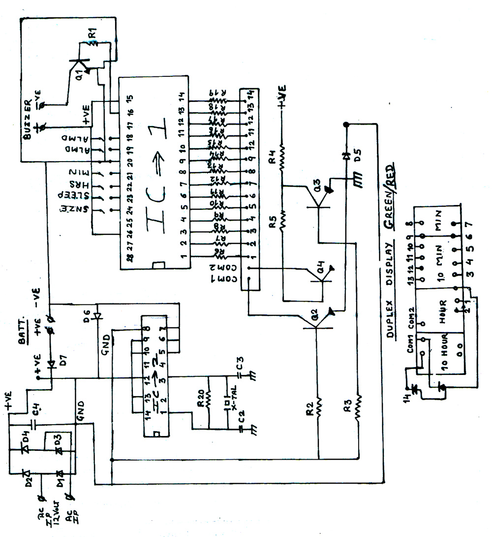

hello,
i have brought a kit of "digital alaram clock".i soldered by my self and it is working properly.i have to submit it in my college.but i dont know how it is working.because what schemetic diagram is there is very confusing.there are two IC's IC2 is CD4541 and IC1 is LM8560.one crystal (of 3.278 MHz)is connected to IC2.but there is not a singal connection which is supplying clock pulse or any type of pulse to IC1.whereas IC1 is clock cum alaram manager cum BCD to 7-segment converter cum 7segment driver,and v all know that clock IC need 1Hz or any type of pulse(which is not provided),then how the IC2 know when to increment the logic state or at what interval it has to give "COLON OUT".please write me an detailed working of this circuit if possible.i can provide u any material u want for proper understanding.i m attaching schemetic diag.,datasheet of both the ics and PCB LAYOUT of both Cu and component side.thanks

Looked at the circuit drawing, its incomplete also has some errors.
Is this the original drawing that came with the kit.?

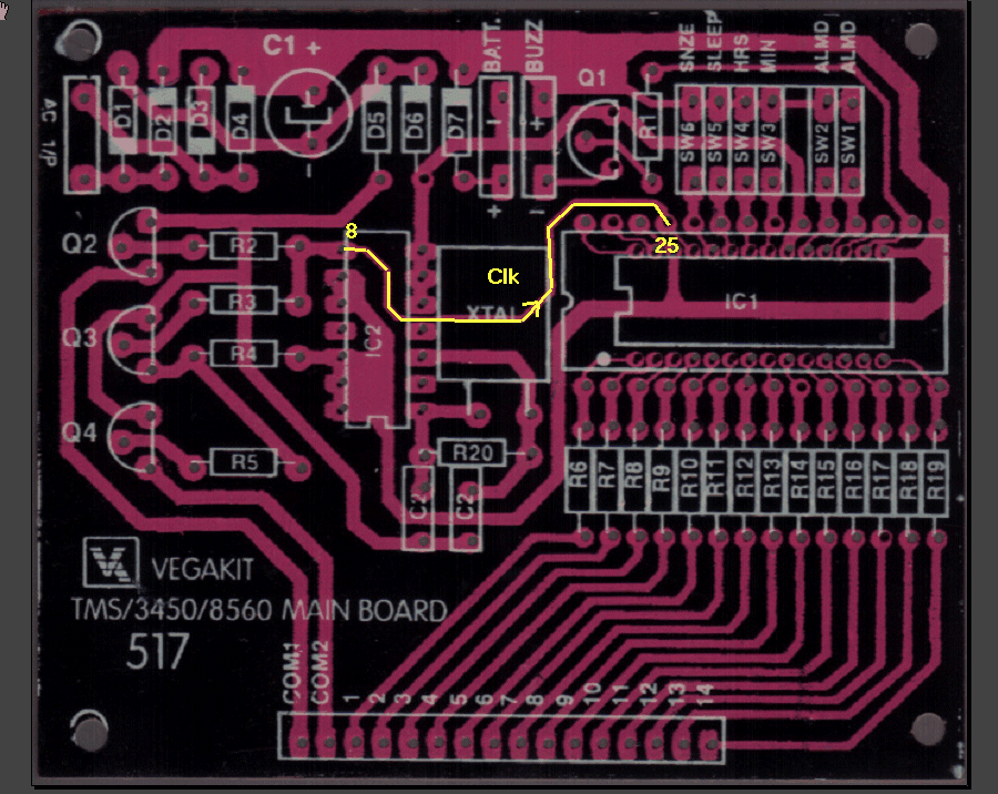

EDIT:
look at this image for 'missing' clock. Not shown on diagram

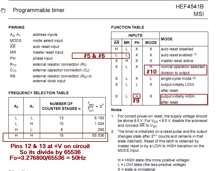

The HEF4541 is set to divide by 65536 from the 3.2768MHz crystal, so the LM8560 is being clocked at 50Hz on pin #25.

hello sir can u tell me how the pins of IC 4541 r configured?means if v take example of IC7490 than for decade counter pin no:2,3,6,7,10 are shorted and ground where as for devided by 6 counter it's pin no:7,6,10 are grounded and pin 2-9,3-8 are shorted.similarly as v knw that 4541 can b used for 2 raised to 4,8 and 10.so two obtain this all operation?(including 65536 counter).thanks
The HEF4541 cannot be configured to give 'powers' of 2 from 2,4 and so on.
There are only 4 division States, look at this attached image.
I have marked the image showing the pins# used and the way the circuit is using them.

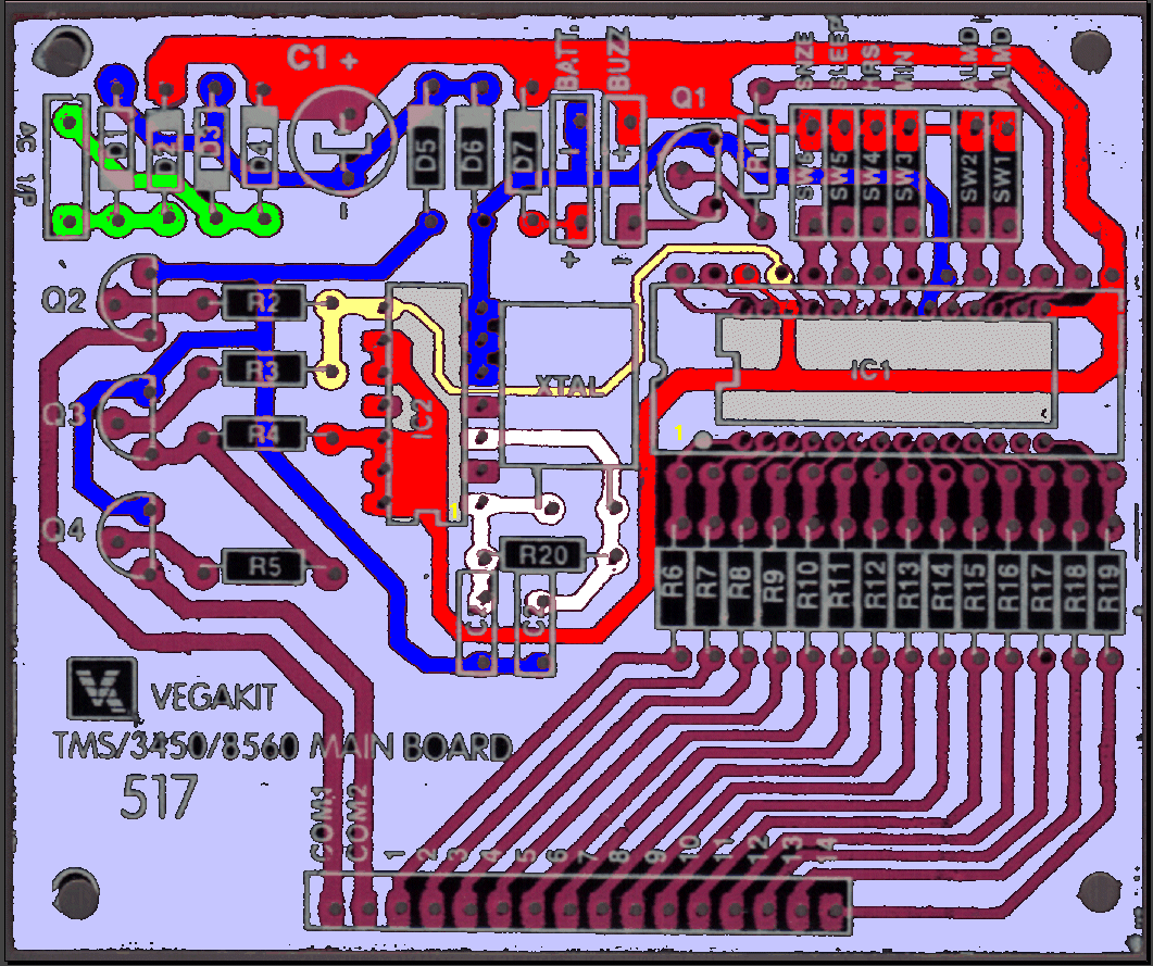

Your circuit drawing has errors which if you follow the copper tracks shown on the component side you should be able to correct.:)
Look at the coloured image of the pcb, it should be easier for you to follow.
