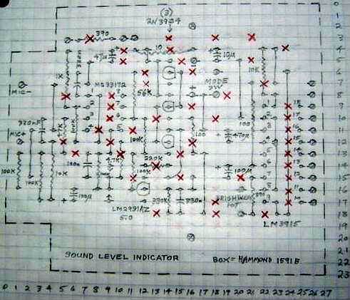

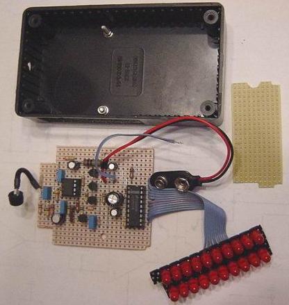

I have made thousands of circuits, some very complicated on "stripboard". It has parallel rows of copper strips and is perforated all over with a 0.1" grid. Each copper strip forms most of the printed wiring of a pcb and the parts and a few jumper wires form the remainder. Each copper strip can be used for many parts of the circuit when it is cut with a drill bit, just deep enough to cut the copper but not make a hole. Every item is soldered to a copper strip.
I plan each circuit layout on grid paper to be as compact as is possible. The red X's are where a copper strip is cut:
