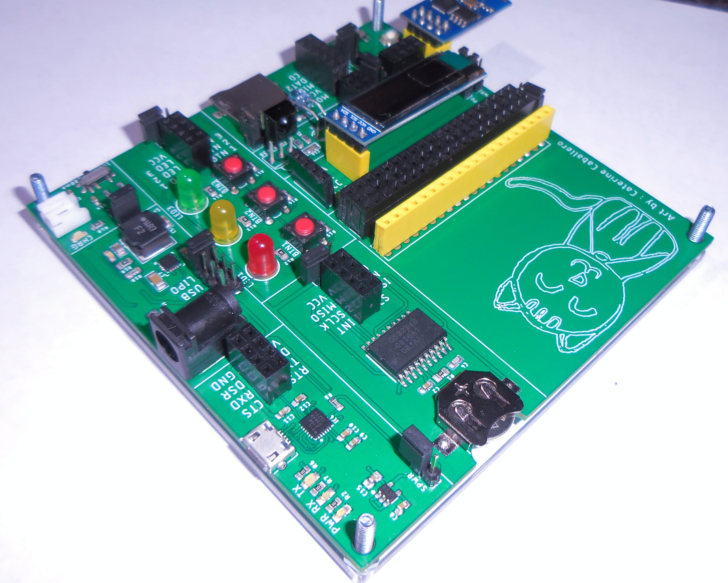

Hi everyone havent been here in a while i know. Sorry. Having 3 kids, moving 3 times and worked 3 different jobs... (hah all 3's) can lead to having little to no time. But i seem to be settling down now and i wanted to ask my fellow members and community...
What would you like to see on a dev board?
Some basic components like OLED, LEDs, BTNS etc..
Check out my blog, link below. I created a small dev board and wanted some feedback.
I want to know what people think and what they would find useful.
What MCUs are more popular these days.
Dev boards are generally aimed at specific usage, for e.g. Microchip sell many different boards, general/multi purpose such as the Picdem version with various input sensor devices, to the more specific aimed at either BLDC or DC motor control.
The Picdem has various sized sockets for different pic's, fortunately Picmicro's have a fairly standard I/O pin definitions across part No.'s.
The other popular ones are made by Olimex etc.
Although I found the problem with these, (Olimex) is they do not have an easily way of creating connections for external devices to the micro itself.
Max.
Thanks for the tip. Ive tried to make my dev board more like the MikroE type. Where as you can change MCU. i plan to add a CLICK type feature as well. The issue with MikroE is they are really expensive. But they are beautiful.
With the availability of free schematic capture S/W (Kicad etc) and the low cost of having boards made out of China, it is relatively ease to acquire a range of different boards.
Max.
Yeah that's true. But time is a huge factor also. People have to waste time when designing and testing. Then sending a board out to get made then at usual.. 1 week to get a board back then if there's an issue.. it's a hassle for some. Having a dev board sheds weeks off development time. Not to mention the cost of pain killers for those headaches that will come when you make a mistake or the board house does.
It's nice to have a couple frequently used items on one board you can decide to use or not. No need to breadboard stuff and then being able to use different mcus. It makes development of firmware and software on PC quick. So you can focus on a end product or just test ideas without having to make smaller pcbs

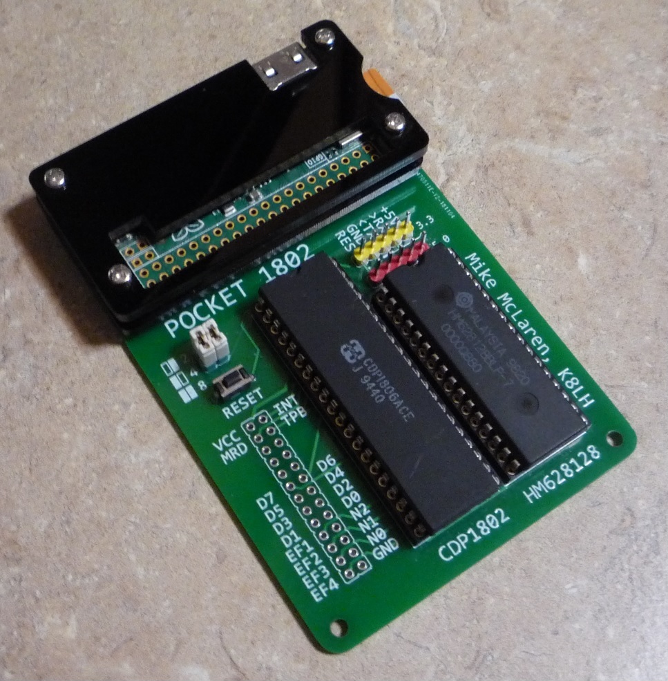

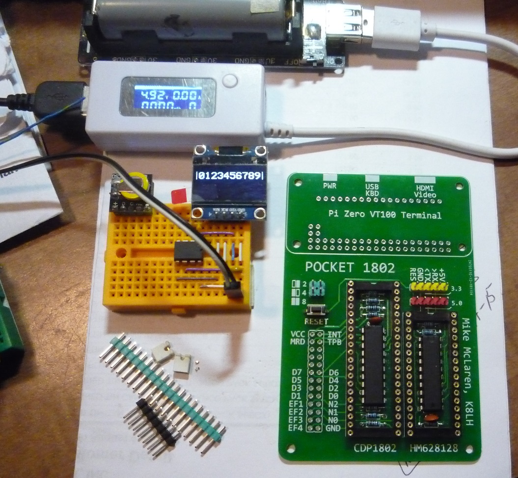

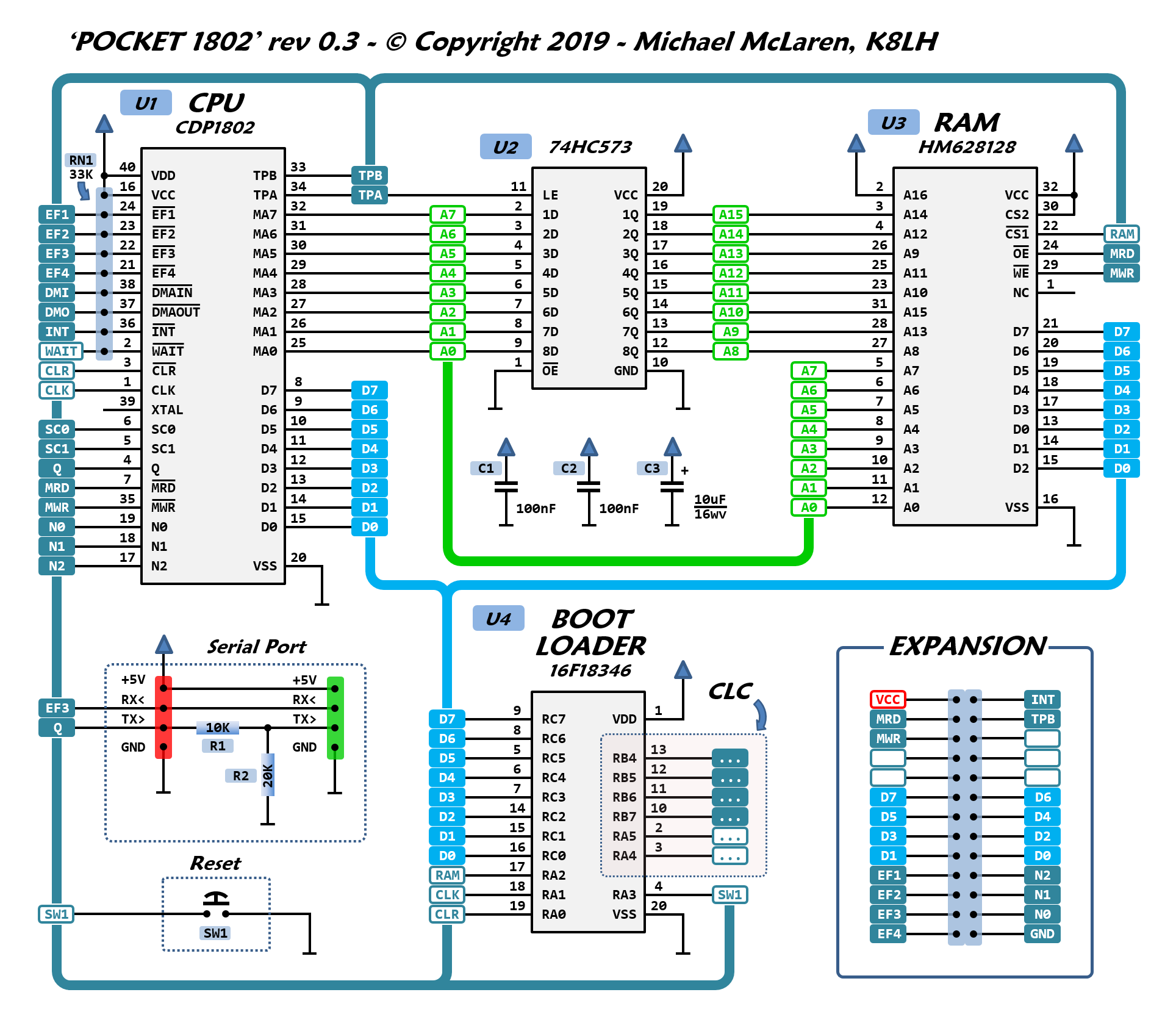

Jason... If you're interested... My last PCB was for a Retro Computer with a CDP1802 processor.
