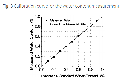

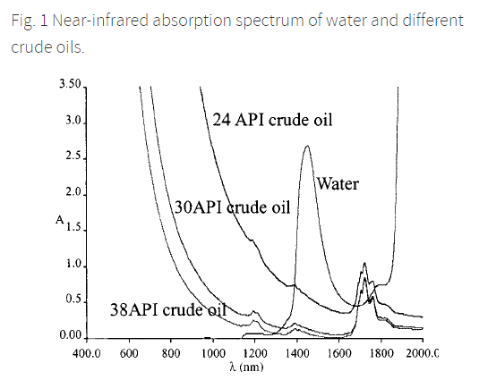

I looked at one of the MSDS's. New Jersey lists it as requiring mineral oil precautions. But that does not mean it is a mineral oil. It is also said to be "inherently" biodegradeable, which may mean it is not a mineral oil. Do you know off hand whether it is a mineral oil? Also, color is not described, but the name makes me wonder. Is the oil highly colored, like purple? If it is not a mineral oil, the near IR method may not work at all. We would need to check the IR properties of the oil.
The fact it is in a motor is good news. I was thinking it was in some sort of tank, but a motor will keep the oil-water mix agitated. I have a small, 5 HP gasoline-powered sprayer for the farm. You can easily tell if any seals are leaking from the water side into the oil side (mineral oil). As mentioned above, turbidity may be a simple answer.

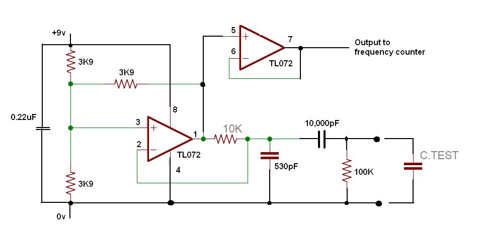

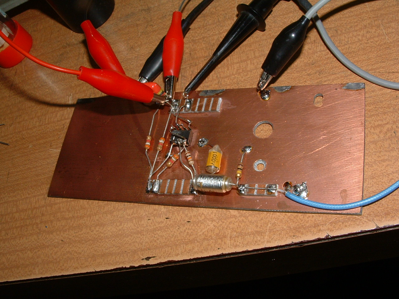

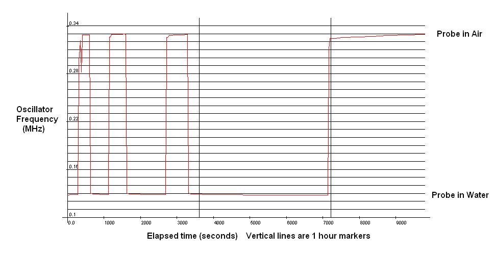

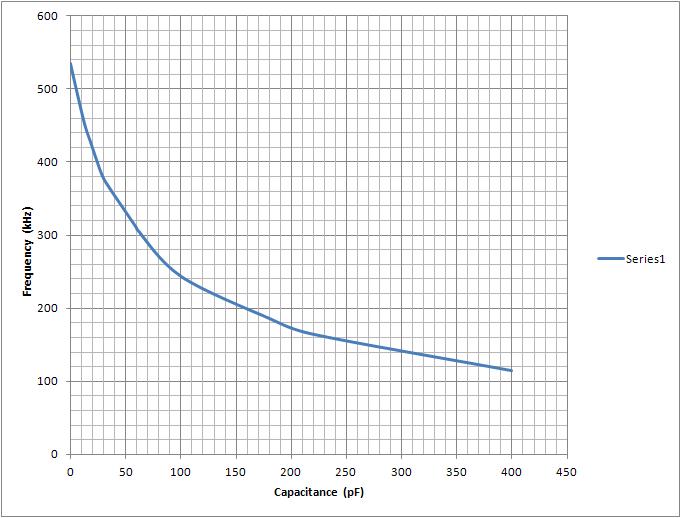

So a few possibilities have emerged:
  • sensing change in capacitance
  • sensing change in visual properties
  • sensing change in resistance
  • employing dark arts
I will try to evaluate these in the order above until one of them works. I will let you guys know what I find. FYI I will not begin testing for some time, maybe a few weeks.

I'm late to party but what I know of water detection is mostly from diesel equipment fuel systems and used oil burning.
On many of the diesel trucks they just use a simple two or three prong platinum or similar metal conductivity or capacitance sensor that sits down at the lowest point in a filter housing.
As far as I know they basically doing a lower voltage megger test of the fluids or a conductivity/capacitance comparison between the three electrodes.
Now as for water entering an oil obviously seawater will change the conductivity of the oil far more so that condensation water so that's one way to detect it on the go or from the bottom.
Also depending on whether the oil is hydrophobic or hydroscopic will affect things too. A good hydrophobic oil will only hold the bulk of the water in emulsion if it's being continually stirred up which although would make on the go monitoring a bit more difficult the moment the fluid mixture gets into an area of the system where there is not enough motion to keep it emulsified it will start to settle out and thus be easy to detect with a simple conductivity sensor located at a low point in the system.
Either way conductivity or capacitance based monitoring with reference to a known clean baseline value should be able to pick up water contamination fairly easily.
As I see it either off the shelf or roll your own it should not be a hard thing to work with.
