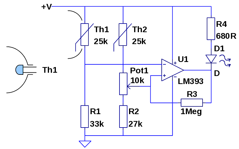

Are there any similar or alternate solutions that are less expensive? That module is over 1/4 of my project's budget ><.
Here's an idea.
Use a thermistor and a parabolic reflector from a torch (flash light)
Th2 is the compensator which is inside the box and is at the ambient temperature.
Th1 is the sensor.
The circuit works by looking at the difference in temperature between Th1 and Th2, then Th1 is the warmest, the D1 is turned on.
You'll need to adjust R1 until D1 is off but is triggered when Th1 is near the heat source you want to detect.
R3 adds some hysteresis to the circuit, there might be too much so increase it to 10M if you like.
U1 could be the LM311 rather than the LM393. The LM311 has a higher output drive capacity and will drive a small relay, without an additional driver transistor.
Reference:
I got the idea from Forrest Mims Sensor Projects, page 42 & 43.
