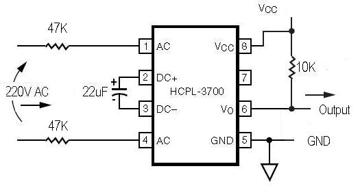

I want to detect voltage between 10V and 260V AC / DC, I have thought to use the HCPL-3700 but if I put the 47k resistors the output is activated, but if I apply 12V the output is not activated.
schematic
Does anyone know if it can be done with this chip, or does this one not work and I have to use another type?
Basically I want to activate a 5Vdc PIC with whatever voltage is applied. I don't need zero crossings or anything special, only that it be activated with that input voltage range.
Any ideas?
Thank you very much
The input side of the HCPL3700 can stand up to 50mA.
As long as the current is below that at the highest voltage in your circuit, you are OK with that device.
47K + 47K means the current at the peak of the AC cycle with 260V input is only around 4mA.
You could reduce the resistor value quite a lot without overdriving the IC; you just need to ensure the resistor power rating is appropriate.
eg. Two 22K 1W or higher resistors should give a rather lower minimum detection voltage.
There are also many other circuits you could use.

If I want to detect AC and DC do I have to link the (pin 3 with pin 4) and the (pin 1 with pin 2)? and remove the capacitor ?.
What other solution can you think of?
Thank you
No, the device has an internal bridge rectifier so the inputs are not polarity sensitive.
Alternatives are such as using a conventional but high CTR optocoupler with an bridge rectifier, plus the resistors to limit the current.
eg. One with a CTR of 500% will sink fie times more current at the output than the current through the LED; it should work down to near 100uA at the input to switch the 10K load you are using. If the LED can take 20mA, that gives a 200:1 possible input range.
If the electronics are part of the same device as the input voltage (so that is always related to the electronics ground) you can use a differential amplifier with a resistive divider input.
Or an opto type circuit with the input resistors split, so two in series at each input. Add eg. back-to-back zener diodes between the two junctions, so the voltage applied to the "inner" resistors is limited; that also limits the maximum current to whatever those resistors allow; the outer resistors take all the excess voltage.
Much more complicated.
I will continue with the HCPL3700.
Does the 22uF capacitor shown in the diagram have to be 400V?

The capacitor voltage is 1.414 times higher than the AC voltage. Take the highest the AC could get then find the peak of that then add a little just to be safe. Yes 400V.
Datasheet: HCPL in ac mode. It takes about 5 volts to turn on the part. (4.23/5.0/5.5 min/typ/max) So when you think about low voltage and low voltage you need to substract 5.5V. 12V-5V=7V There will be 7 volts across the resistor.
Input current: You must stay below 50mA. I think it is unsafe to use the part at absolute max current. From experience, the part will fail with time.
It takes 3mA to turn on. (min current)
I do not see how you can reach from 260V to 12V. The part is intended to work from high line 220 to low line 110. I can see maybe getting 10: range.
The cap is across the device internal clamp; a 16V or 25V cap is fine.
The highest voltage between pins 2 & 3 listed in the datasheet is 13.4V, using a direct DC feed rather than the resistors to pins 1 & 4; it should stay below 10V with 2 x 22K series resistors.

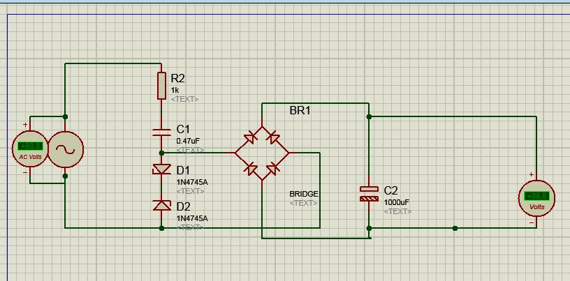

I have simulated this circuit with 5V zener and it works fine. In the output I will connect the optocoupler.
That won't detect the DC.
The problem is that any linear circuit with only resistors that will make sure that the HCPL-3700 operates at 12 V will allow too much current at 240 V.

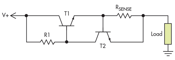

You can add an external current limit circuit with high voltage transistors, in series with the chip input.
Current limit
I can not find it now but I have used a low current version..... high voltage constant current IC. Can be set to 10mA or any value you want. Up to 900V.

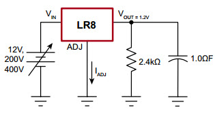

Hello, has anyone used the LR8 microchip? It seems like a good solution.
Input voltage + 12V ... 450V
