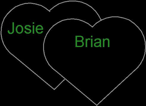

I'm still in the design stage at the moment but shortly I'll be wanting to design a PCB. I want to arrange a quantity of LEDs into two heart shapes, and I have a drawing of the shape and size that I'd like. The question is, how would I go about transfering that intended shape into a PCB artwork? I need to go from the hand drawing to a CAD layout somehow.

Oh, in Eagle, just make a device with pins arranged in a heart shape.

Ahh I forgot to mention that I use Eagle as my CAD layout program. But I'm not quite sure how one would go about creating a shape on it. I suppose I could create LED points on my hand drawn shape and then use co-ordinates to place them on my CAD layout.
I can't think of an easier way...
Yeah I understand I can make a shape that way, but I'm not confident that I can make an accurate heart shape in that manner. Hence I wanted a way of transferring my hand-drawn diagram somehow. I don't think it's feasible though so perhaps I'll have to measure some co-ordinates on my diagram and do it that way.

Here, I did this in BRD, not new library. Is it what you had in mind for the shape? Just use arc and straight lines.
hearts-png.25709
The zip file should open in Eagle. Not sure I got your girlfriend's name right. I used tPlace for the outline.
John
Hi John - that's a very good attempt at a heart shape, I'm very impressed! I didn't actually want to lay out a heart shape in the artwork though, I wanted to place LED footprints in such a manner that they would represent a decent heart shape. I've managed to draw some decent heart shapes, but the problem is deciding strategic positions for the LEDs to obtain the best effect. LEDs will need to be present at all the peaks and troughs of the shape, and then I'll need to work out an equal distance between them to distribute the rest. After that I need to transfer my work into a PCB layout. The main point of my question was to ask if anyone else on here has tackled a similar problem before and how did they go about it.
