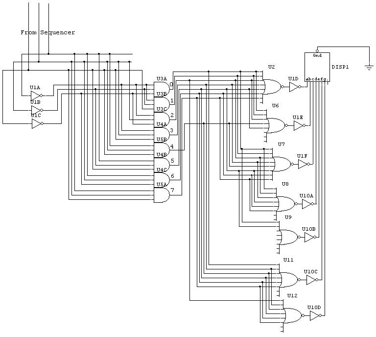

Need Help!!!!! Designing a circuit for a 7 Segment LED counter to display your student number (07354855)

Build a circuit using only AND, OR, NOT, NAND and NOR logic gates to simulate the counter. You should use 3 sequencers or bit generators in your circuit as input. Draw your circuit using Digital Works 95. The numbers should change automatically without any user input.

I have got as far as the first row of AND gates but cannot seem to get the right gates to connect to the LED display to generate the required sequence of numbers
ok bro here is the circuit. when u give the input of (000 001 010 011 100 101 110 111) from the sequencer. It respectively displays 07354855
