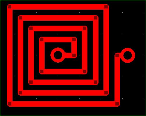

I would like to lay out inductors (VHF range) on a PCB.
Does anyone have a reference that gives practical advise on laying out inductors using traces on PCB's? :confused:
The PCB layout package I use is directly linked to the ExpressPCB fabrication house. IMHO it is a good value, $51 US for 3, 3.8" x 2.5" 2-layer PCB's.
The layout package cannot make arcs in the trace, so I am limited by rectangular "spirals" for inductor layout.
Any help would be appreciated!

I use eagle cad and have made round "turns" but square and rounded turns are simple. In eagle I can set the grid to any value. Grid=0.1 and trace width=0.09 gives 0.01 gap. If i need more turns; grid=0.08 and trace = 0.07.

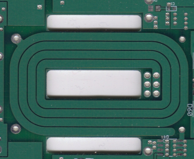

I made some 30 watt transformers in the PCB using 4 layer boards.

Hola Ron,
Could you give some details?

Attached is (a small piece of a larger PCB) a picture of a transformer in a PCB. The transformer is 1 inch by 1.5 inch. The 3 holes in the board is where the core goes through the board. This was my first try. My second transformer windings are very different.

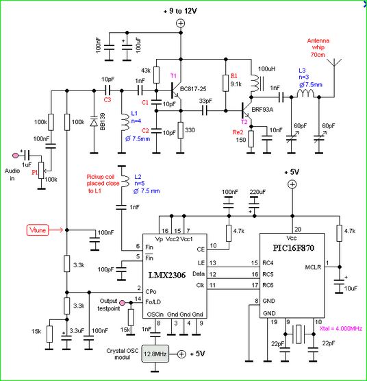

I am building VHF transmitters for radio locator beacons; I would like to put the main inductor on the top layer, and the PLL feedback inductor on an adjacent trace, the bottom layer if a two layer PCB, or the next layer down if a 4-layer board.
Will I have any capacitance issues with the VHF tank circuit if I put the PLL feedback "pickup" inductor on one layer vs another?

I would avoid this topology completely. You are coupling two loads into your tank circuit, one being the load presented by the oscillator transistor and its follow-on load, the other being your feedback coil. In addition, you run some risk of the switching noise that may find its way out of the feedback input to the synthesizer getting directly into your tank circuit. Why suffer this complexity when it would be simpler to simply tap off the oscillator output with a capacitor to provide your feedback?
For my transformer, layer 1&3 is primary and 2&4 is secondary. I want close coupling.
There are calculators for pF between layers .
There are calculators for uH from turns ,diameters.
The short answer is I do not know any better, I am trying to borrow from circuits I find on line; about the only thing I do know at this point is:
