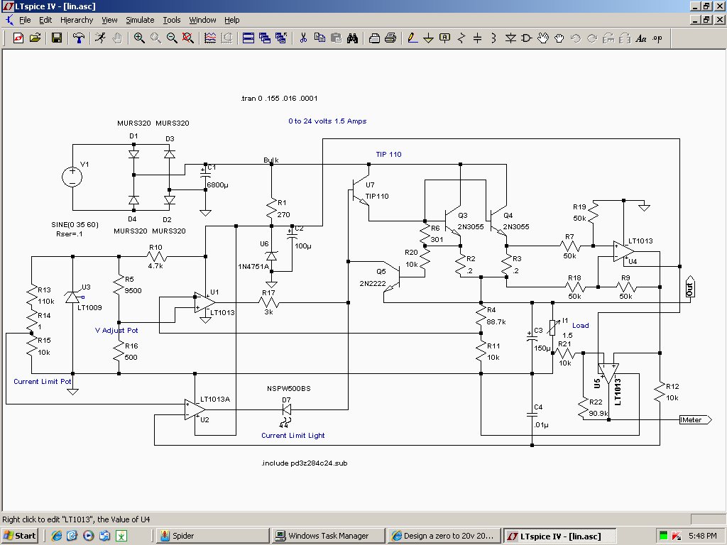

Linear supply
Here is a linear that would probably do if you have a pre regulator. I haven't built this yet, but it simulates okay. Let me know if you are interested and I can attach the files or mod it for your 20 amps at a few volts.
Maybe everyone could critique it before I build it.

ronv- Interesting regulator, but it's too complex for what I want seeing as I have to build a large high power switchmode regulator too.

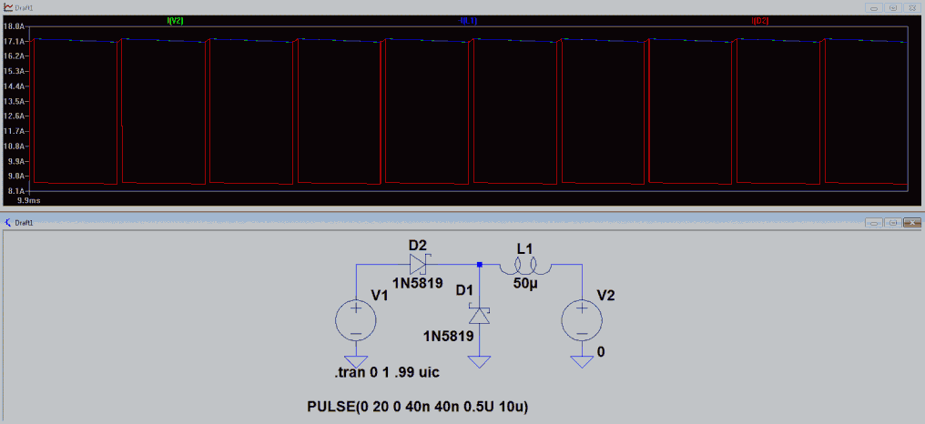

So 20A from 40v via 0.1 ohms will be a voltage conversion of 40v: (20A*0.1) or 40v:2v so the duty cycle is 20:1 which means peak current is 20*20A or 400 amps!
This is running discontinuous mode, I take it. Try running in continuous mode - the peak current should about the average current + half the ripple current, surely?? So for a ripple current of 1A, peak current should be ~20.5A...
Here's a simulation of ~17.1A into a 0V load. Peak current is ~17.2A, ripple is ~0.2A. Please ignore the fact the diodes are a little underrated...

Dougy83- I apologise, you are right of course. If I run continuous mode (which should be easy enough now the duty cycle is not so severe because of the added output diode drop) the peak current gets very managable, but I think the ripple current will be pretty big maybe 60% or so as I want to keep the switching freq down as close to 20kHz as possible.

No need to apologise to me; I have oversights every day. If you're worried about the pulse width being too narrow, maybe try using a different control method, e.g. constant on-time. 60% ripple would likely require a horrible design. I don't see the desire to use a series diode in the output to be a nice solution.

This LINEAR Supply will give the Output you want.

Chemelec- Does that supply regulate right down to 0v? It looks like your voltage control differential pair is well above 0v but I might just be misunderstanding your voltage regulator. I'm reluctant to use a full linear supply because it's main usefulness will be at very low voltages and med-high currents, and my transformer makes about 40v DC...
Dougy83- The output diode may not be necessary as you said. At 0v output and a very low duty cycle the buck diode will be in circuit most of the time anyway, I forgot to add it's voltage drop into the duty cycle calc but even a good schottky will probably drop 0.5v at 20A. Thank you for the input, I do appreciate it.
YES, It Goes to ZERO on Both Current and Voltage.
(I have Two of these rated at 36 Volts and 8 Amps each.)
