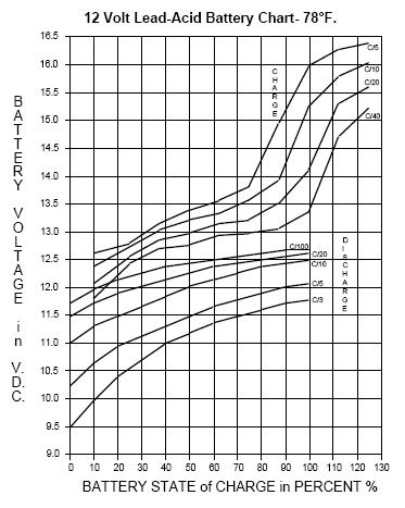

Many terms are bandied about with rechargeable batteries. Deep Discharge to 100% DOD is a term used for deep cycle batteries as used in Golf carts and stuff...
I understand a 12V battery going down to 9.5V probably in Deep Discharge under load.
Problem is how does one work out say 50% DOD with a known battery AH capacity and known load??
I ask this because the Internet wont tell me. I am not acting dumb. I cannot find answers.
Here it is:
1. 65Ah Sealed Lead Acid battery.
2. Constant load say 10 Amps from the battery
3. With the constant and consistent load...at what point should the Battery be shut down because it has reached 50% DOD?
Probably a huge question...I need to know the Voltage to shut off. Could be 12V or maybe 11.5V or maybe 11V.

Here is one.
Edit:
Did I tell you nice avatar?? :D

Ampere hour capacity varies from battery to battery, even of the same make and model. When new it should deliver the stated capacity and the test loads will show up on the data sheet for that battery. For a given load, you should be able to find out how long you can run that load to get down to 50 percent capacity. The time will vary with load and it is not linear at all but follows an exponential law, but looking at the data sheet they should show different capacities at different load currents.
As the battery ages however, the capacity does down. That means if when new you could load it for 32 hours with 1 amp to get to 50 percent, you may have to cut that back to 25 hours for example when it is a couple years old. You may be able to get some idea what to expect from the data sheet by looking at the capacity with aging graph if they provide one. If not, you may have to just wing it.
While the battery is powering something you can integrate the current over time to see how much capacity has been used so far. For a constant current this is easy. Once you establish an operating set, you could probably go by that for the future use of the battery. In other words, get the 50 percent capacity voltage from the data sheet and time how long it takes to get to that voltage with your given load. Each time you recharge, start the timing procedure over again, so if it took say 20 hours to reach 12.2v when new and that was 50 percent capacity, then note how long it takes to get to that same voltage each time the battery is used. If it gets down to 12.2v in only 10 hours after several uses, you know the battery is getting old.
The key here though is the data sheet, for the first measurements. After that it's just a matter of timing the discharge to the same point each time it is used.

ronv gave me the info I was looking for. Could not find the graph on the Net. Thanked Ron and gave him a "like".

The most accurate method of determining SOC for LA batteries is Specific Gravity, which you cant measure in a Sealed Battery.
Second most accurate is to measure the battery's open-circuit terminal voltage 24 hours after the battery is isolated from a load. Hard to do if the battery is being discharged...
The voltage as a function of load current and time is the next best thing, like in the link I posted...
However, Ron's and my plots are examples only; you need to get one for the specific make/model of the battery you are using...
