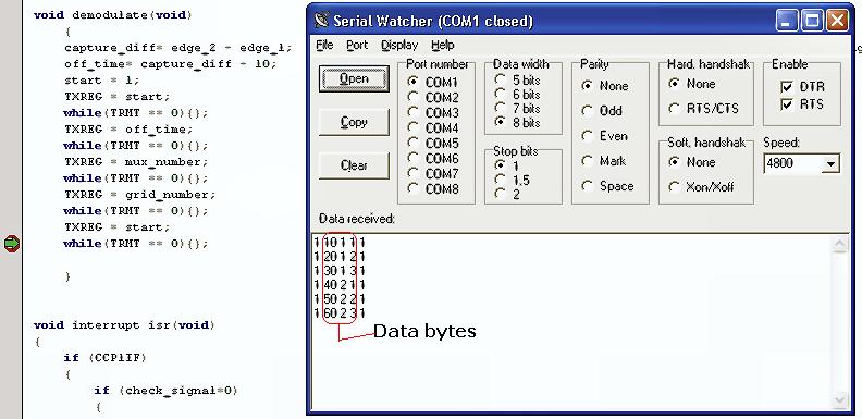

The above line recieves streaming Data. Cuz i am continously transmitting data of various id's I capture. They come in blocks of 5 at a time:
start-variable1, variable2, variable 3, stop (start and stop =1)
i am sure i am gettin this data as i have captured it in serial watcheras shown in the figure. i have marked the data bits in red.
But they dont come in blocks like that, they arrive in a stream. I have just got them one below the other in the pic to make it easier to show the information

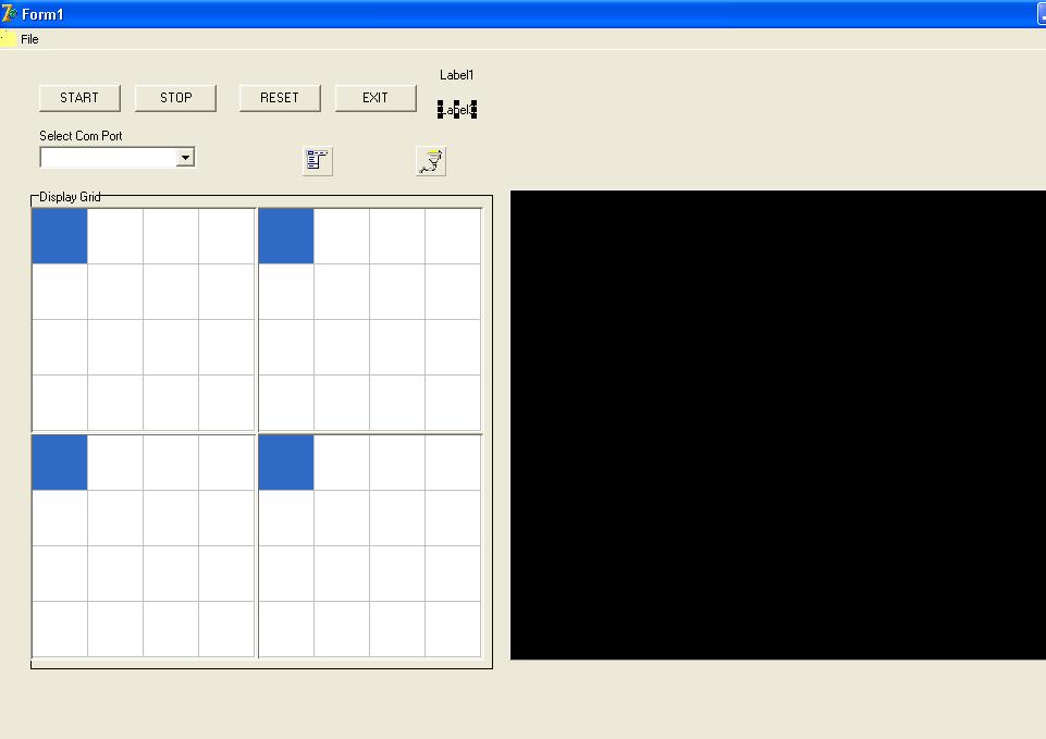

procedure TForm1.display_robot(muxid,grid_number,robot_id: integer);
where in i am hoping that i have somehow assigned variable1 to robot_id, variable2 to muxid and variable3 to grid_number. And i expect them to be integers as i am transmitting them as such.
To basically use them to display robot id's on the GUI (as shown in second figure)
Would appreciate any help very much, as i have been playin with Delphi since 9 am with this problem (itz now 9pm), but of no avail.

OK, so first of all you need to understand delphi strings..
character:= VaComm1.ReadText;
This you say is pulling in 5 bytes.. but of course they are characters..
character[1]
character[2]
etc is the way to access each character
Then you can do an ord on each one to get the integer value
var
intValue : Integer;
character : string;
begin
Label3.Caption:= IntToStr( Ord(character[1]));
Label3.Caption:= Label3.Caption + ',' + IntToStr( Ord(character[2]));
Label3.Caption:= Label3.Caption + ',' + IntToStr( Ord(character[3]));
Label3.Caption:= Label3.Caption + ',' + IntToStr( Ord(character[4]));
Label3.Caption:= Label3.Caption + ',' + IntToStr( Ord(character[5]));
end;
The above could should give you a string of numbers on the caption like
1,20,1,2,1
Hope this helps.
