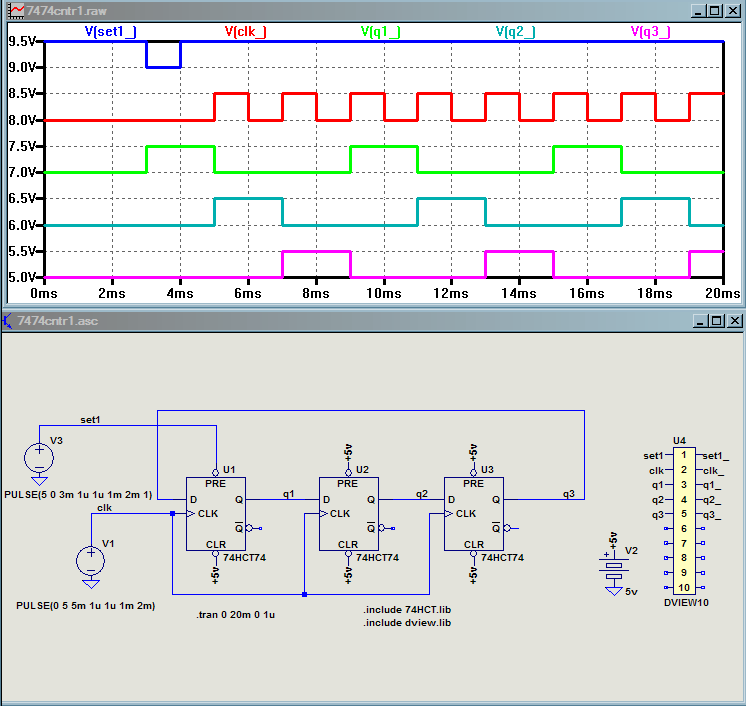

I am going to make a 3 bit ring counter using 3 7474 D-FFs. It is my habit to first simulate and then actually design, the PSpice capture simulation is as,
Now what I want to ask ?
How to generate the P2 signal which is LOW for 2ms and then HIGH (for ever till the supply is on). It is like u(t-2ms) where u(t) is unit step function (=1 for t>0 and =0 for t<0)
Or is there any other way to load 100 in my counter automatically just after turning on my counter.
Using a 555 timer I have to give trigger but I want P2 automatically i.e., as soon as I turn on the main supply the counter starts running 100 should be loaded automatically.
Please reply soon I am in a great need of it.

Post the LT spice 'asc' file, with some added notes, we can see better what you are asking for.:)

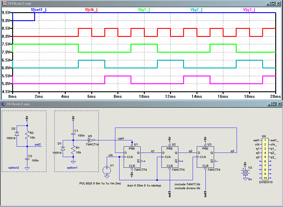

Is this what you are asking.?
7474a.gifView attachment 7474cntr1.asc
Are you asking how to make a "power-up-reset" circuit? A circuit that will generate a Reset pulse to flip-flops every time power is applied?

Yes the same thing how to generate set1 pulse.
In simple words How to generate,
by using hardware ?
Look at this circuit for a hardware solution.
I prefer Option #1, using a schmitt inverter to give fast well defined switching levels.
Note: that F/F's #2 and #3 are also RESET by the SET pulse to F/F #1, so that the states are: 1,0,0

With 7474s, it takes a low to reset, so a 2.2uF from the reset pin(s) to ground, a 10K pull-up to 5V. When power is first applied, the capacitor is discharged, holding the reset pin(s) low. The capacitor charges via the 10K and the current being sourced from the inputs, removing the reset. When the circuit is unpowered, the capacitor discharges through the 10K into the (now low) Vcc line...
