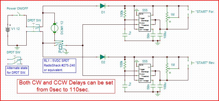

This works:
... I want to run the motor forward to infinity at start up. ...
To achieve this start-up condition (NO delay at initial system 'Power-up"), one or the other of the "Start" push buttons (depending on the position of the toggle) must be pressed. This simply terminates the initial delay at power up. After that, the motor will continue, reversing rotation (following any delay set by either of the two potentiometers) after each DPDT toggle switch change.
Any power up after a power loss, regardless of the toggle switch position, is the same as a start-up, so the above action(s) will be necessary if a delayed start is not acceptable.
<EDIT> Assuming CW rotation of the motor with appropriate polarity observed, upper timer is CW delay circuit and lower is CCW delay circuit. DPDT toggle is shown in CW start position.

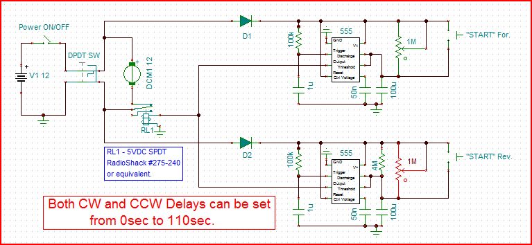

OK cowboybob, now we are getting somewhere! I am assuming the potentiometers are at the 1m location? So I would have to set both pot. controls, one for either direction? also, why is there a 4m resisitor on the bottom and not the top chip?

Also, is there a certain size of diode I need? (I am assuming D1 & D2 are diodes). Are those "Start" forward and reverse buttons momentary buttons? So they should NOT lock in on a push and unlock with another push. Are they there just to let the circuit know which way run? Thanks again for your help guys.
Oops.
Corrected schematic (no 4M resistor [capital "M" for MEG Ohm]):
Diodes can be 1N4004. "Start" switches are momentary push-button types. Their use terminates the delay period timer they're attached to.

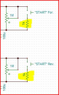

Please note schematic change:
Minor, but improves delay termination.

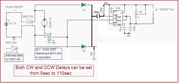

I have a question for you and I am sure you did it your way for a reason, but I wanted to know why to better help me understand circuits.. Take a look at my .pdf... What would happen if we eliminated the lower 555 and tied the diode in this way?

Jeremy, your modified circuit won't be able to retrigger (the 1uF capacitor on the trigger pin will remain high after the initial relay activation). You could try something like the following mod. It relies on the DPDT switch being a break-before-make type, which will allow a small low pulse to be fed into the trigger pin when the motor hits an endstop and toggles the switch.
