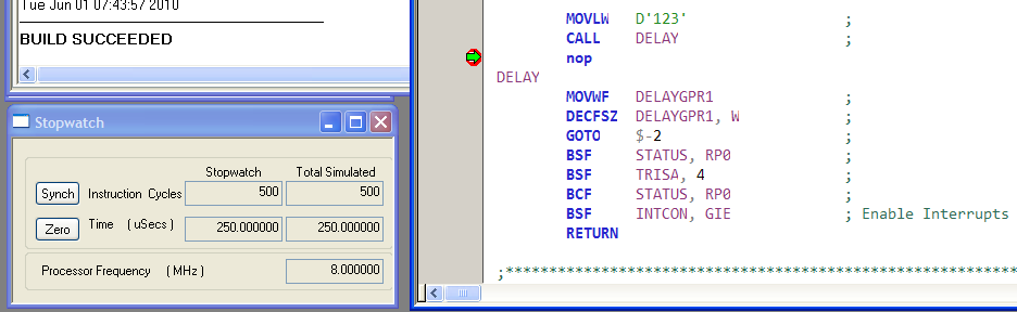

Hey everyone, I would like to double check something here,
Can someone please tell me how many cycles this snippet of code would take to exectue....

I worked it out to be 500 cycles include the CALL & RETURN.
Is that about right?
Yes, it's 500 cycles... It took about 30 seconds to copy and paste it into a program, add the variable equate, and run it in the simulator...

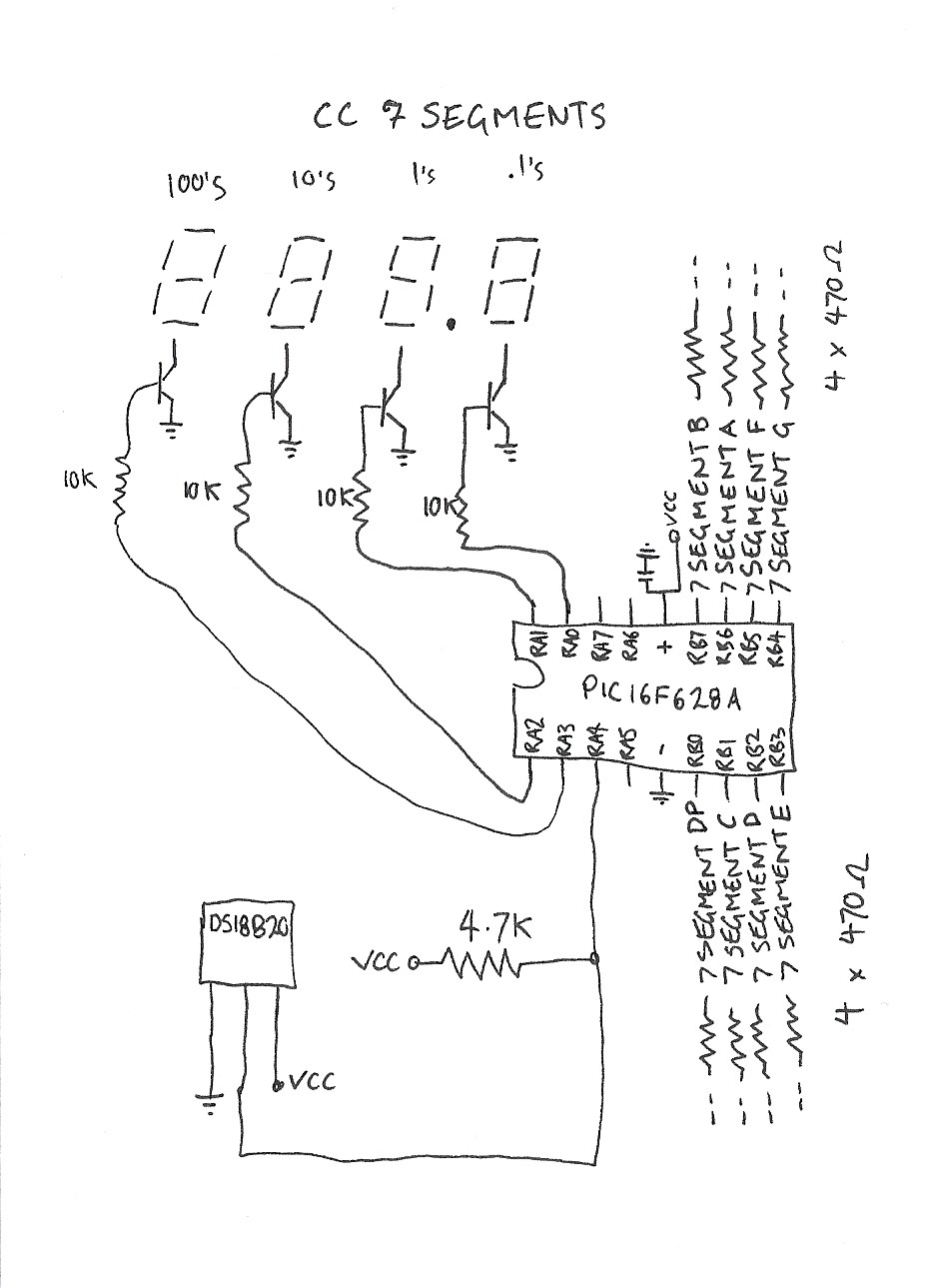

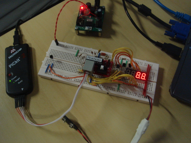

Anyway the reason I asked about the timing was my communication routine with the DS18B20 is still not working, and I thought it may have been my delay routine but they look ok.
Here's the code for the GET_TEMP and communiation routines based on your untested version Mike.
I have the DS18B20 data line connected to PORTA, 4 pulled high via a 4K7 resistor.
Can you see anything wrong with the routines?
Im getting 0.0 displayed, even If i load a dummy figure after the RAM has been cleared. Its like the code below is simply clearing the registers im using for the temp.

All it should do now is move the first 2 bytes of the scratch pad (the temp) to port B and display them on the 2 LSB's of the 7-segment.
BUT im getting every segment of the display lit up. See pic.
So here is the code I've got now:
