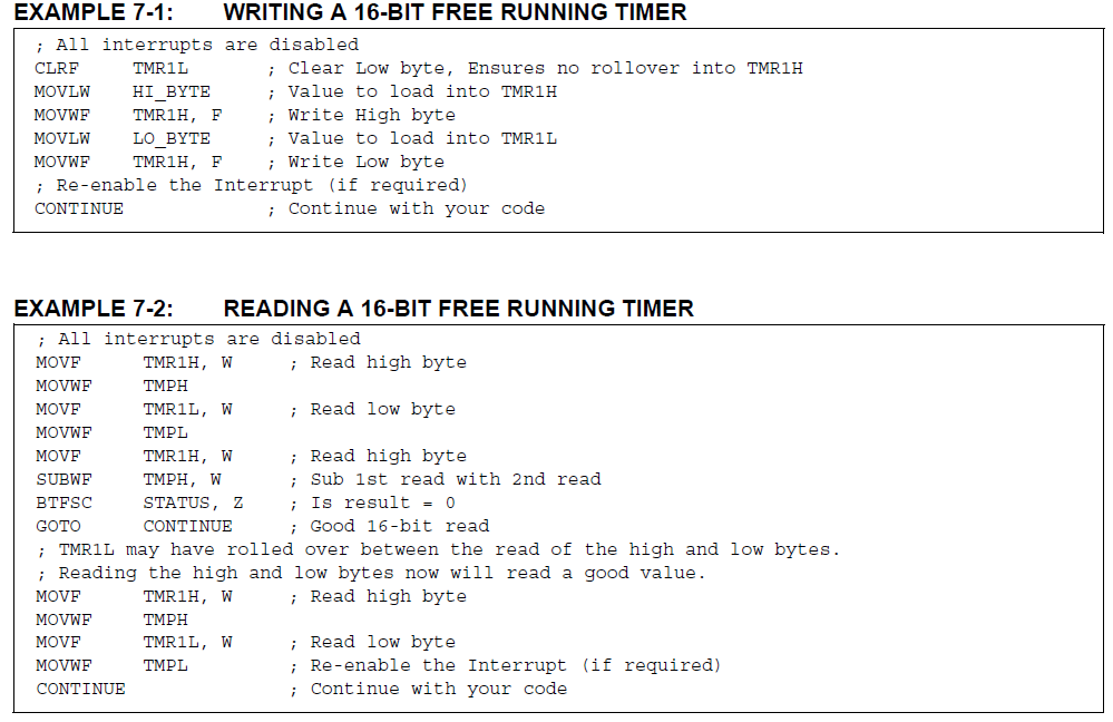

Hi, its all in the data sheet. Heres a picture form the datasheet telling you how to configure Timer 1

mr wond3rboy, I am very confused about the HI_BYTE and LO_BYTE words. are they just word to represent any value that I can assign to them or are they a keyword (HI_BYTE and LO_BYTE) represent a fixed value.
and also, what are TMPH and TMPL? Can I assign any memory location to TMPH and TMPL?
The HI_BYTE and LO_BYTE are values you put in to the Timer registers that determine your delay(you must be doing that with Timer 0 as well).
TMPH and TMPL are simly names of memory locations. You can refer to memory locations by names using the EQU directive.
Download the 16F88 datasheet and go through the Timer 1 Section.
