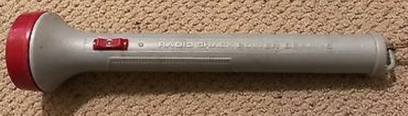

You could put several used batteries in your flashlight, build a joule thief circuit, replace the old bulb with LEDs, you would have a good flash light.
This is my 50 year old antique flashlight. Those old slider switches made terrible connection the light was always flashing on/off and sometime they would go off then you had to shake them or turn switch on/off several times to make it work again. I got tired the bad connected so I soldered a wire to the metal body that holds the light bulb, soldered a wire to the battery contact in the bottom end of the flashlight case, connected both wires to a house light switch, it worked excellent for 40 years and still works good.
I bought several good LED flashlights none of them last long, switches go bad and LEDs stop working. I have 14 LED flashlights that don't work even the expensive ones stopped working.

High current switches do not work well in low voltage, low current circuits because their contacts usually have silver plating that quickly corrodes. The silver turns black (silver oxide) and needs a high voltage high current spark to make it conduct electricity. Many times I purchased switches at an electronic parts distributor like Digikey for low voltage, low current switches and IC sockets having gold plating that NEVER corrodes. They cost the same and are smaller than the switches with thick silver plating.
