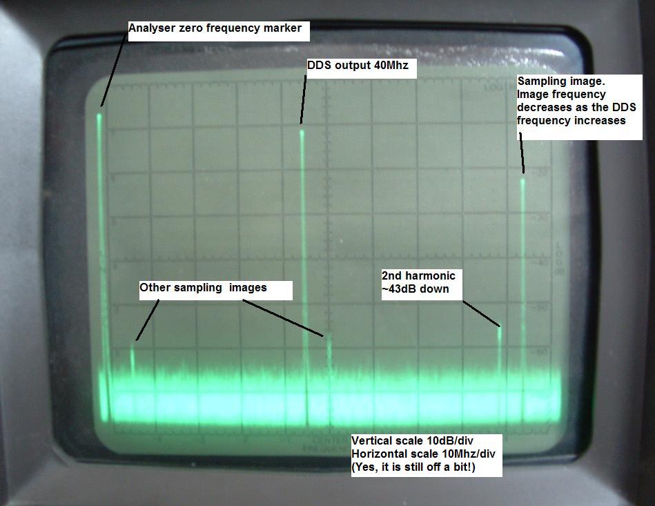

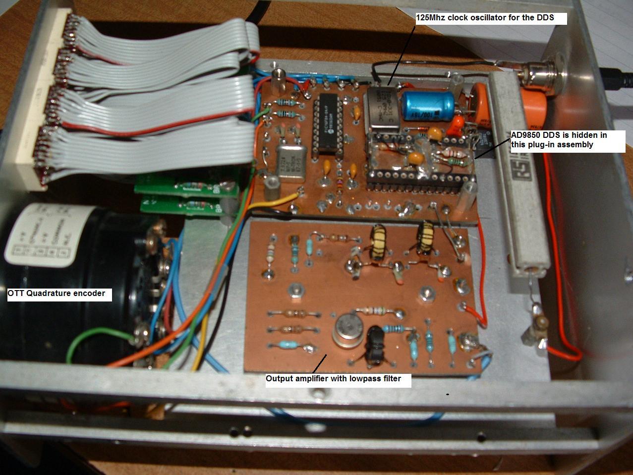

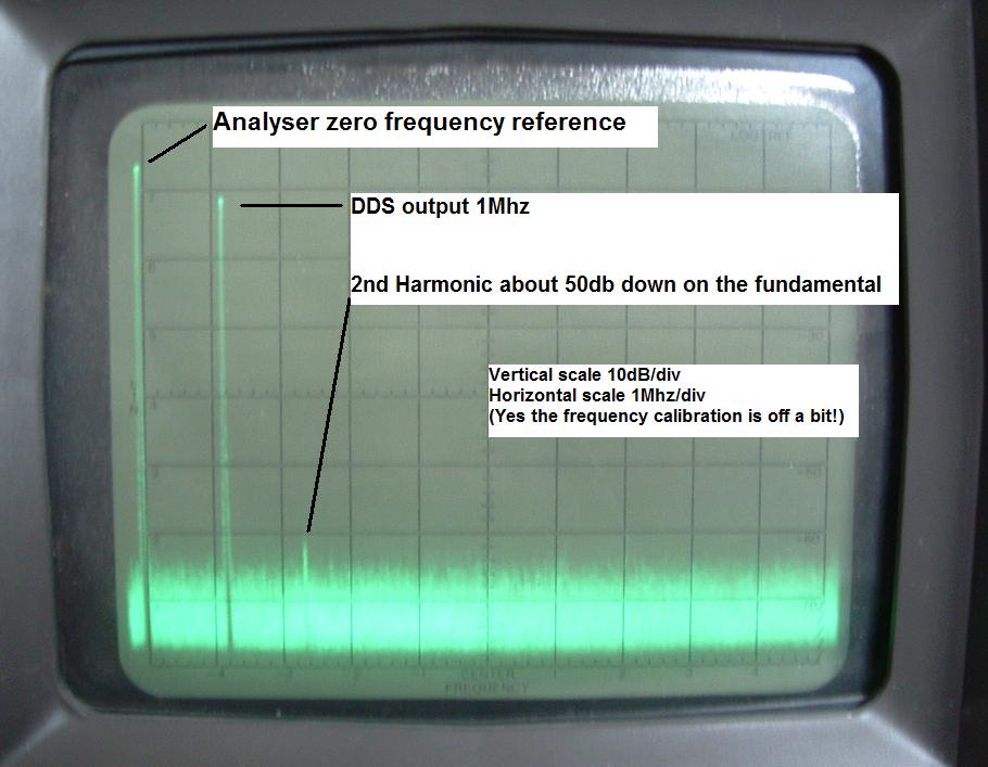

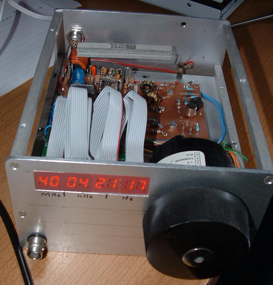

Just to give you an idea of what you can expect, I have taken a couple of spectrum analyser traces of the output of my DDS signal source.
The analyser was connected on the output of the DDS chip (AD9850) before the LPF and amplifier.

Hey thanks for showing me those pics and taking the time to do so... appreciated...
So its the Sampling image that I should be worried about. Looking at the datasheet I see in Figure 12 the image is Fc-Fo where in my case I am running the DDS9851 at a max of 60MHz.... so if I am running at Fout at say 10MHz then the image will be at 50MHz... I need to filter that out?
What happens to the image when you exceed Fc/2 or in my case 30MHz (more than half way?) do you need a band pass filter?
I think the quick answer is yes.
When Fo is about Fc/2, on a spectrum analyser you will see two frequencies close together, if you look at it with an oscilloscope you will see something which looks like distorted AM, the modulating frequency being the difference between the two frequencies (the wanted frequency and the image).
At the moment I cant see a practical use for such an output. (Afterthought, maybe it could be used as a two-tone test for a transmitter linear amplifier - lets not persue that idea, it could get messy).
Have a look at page eleven of the datasheet, figure 8 suggests a method for using the high side image using a bandpass filter.
