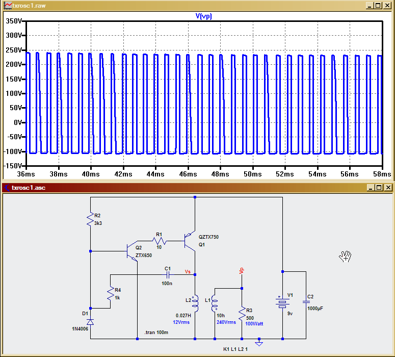

I have asked to build a circuit by transforming a DC 9V battery to output a AC 120V or AC 240V.
I have got this particular circuit online (see attachment )and tried it out, but it seems that I failed. I got 20V AC instead of 240V AC.
2 particular thing seems strange to me as i connect this circuit:
1.) Whenever the 9V battery is connected to the circuit, the multimeter reads as DC 2.5V.
2.) The input to the primary transformer is just 0.4V AC.
Can anyone help me on these problems?
Or rather is the transformer problem?? The specs are, (12V,1A in the primary... 240V in the secondary)

I suspect the transformer and feedback capacitor are failing to make the circuit oscillate correctly.
Do you have any details of the transformer specified in the original design.?

A second transformer will not work as you expect.
What load are you connecting to the transformer output.?
The reason why your 9V battery is being pulled down to 2.5V is because the transformer/100nF circuit is not oscillating, so the battery is being shorted out.
Are you suing all the component values as specified in the original circuit or have you made any changes.?

By adding these 3 components I can get the oscillator to run in simulation, without them it will not oscillate.
IMO a 9V battery isn't strong enough to drive this circuit.
