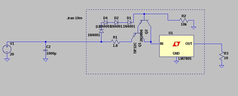

yes you can do it that way. USB ports have a maximum available current of 500mA, so in addition to using a good regulator, some current limiting might be called for as well. a constant current source set to 500mA would provide foldback current limiting, and keep things like a shorted battery in the phone from damaging the supply. it's late now, but tomorrow evening i will try to remember to draw something along those lines.

here's what i came up with for a regulated and current limited supply for the USB. just pay attention to the stuff inside the dotted box. the "idealized" supply to the left can be anywhere from about 12-20VDC. which is what you'll get from a transformer, bridge rectifier and caps, similar to the amplifier supply. inside the dotted box is a constant current source feeding a 3 terminal regulator. below the set current (520mA, 500mA for the load, and the rest for the regulator itself), the input voltage to the regulator is well above it's dropout voltage. when you hit the current limit, the current remains constant at 520mA, but the input voltage to the 7805 begins dropping rapidly, until the dropout voltage is reached and the output shuts off. it's probably a good idea to add an LED and resistor to the output as a status indicator.

Your drawing shows + and - connections. Are you aware that the mains wires (brown, blue) and the transformers provide/use AC, not DC voltages? USB requires 5V DC.
Thanks and yes im well aware, the idea is to pull apart a usb charger....waste nothing me this way the hard work is technically done for me hence the way i drew the diagram
