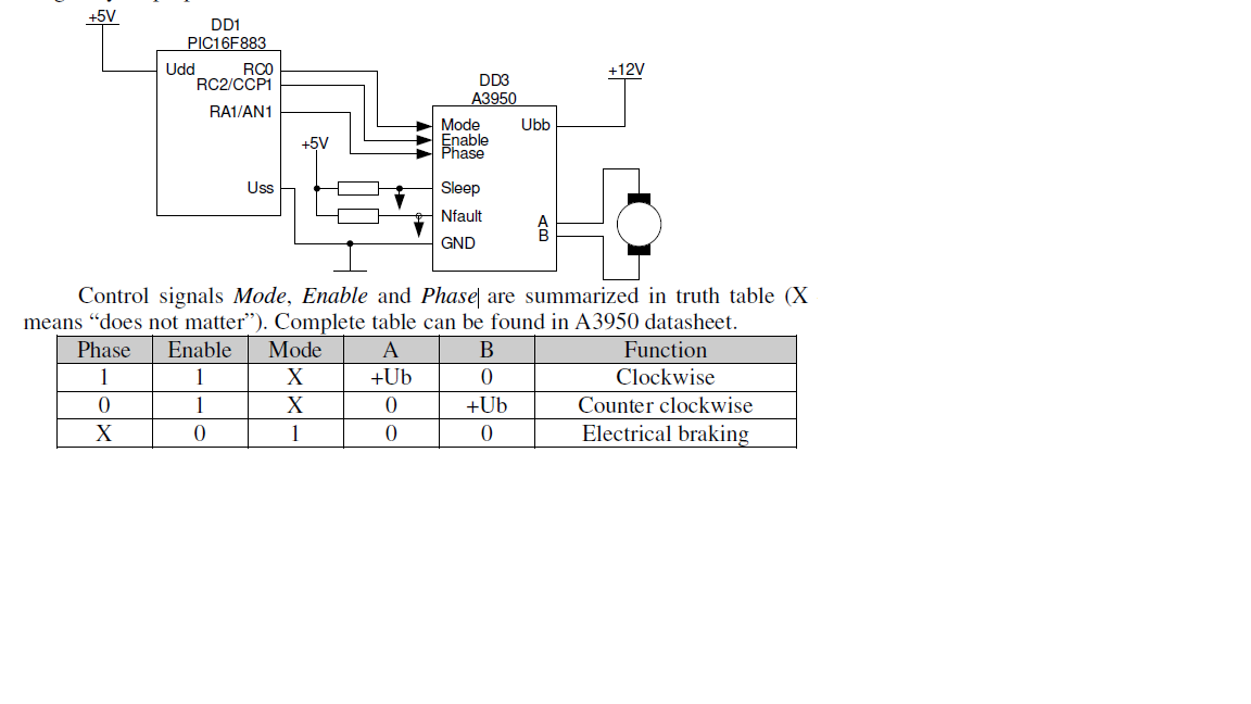

Hello everyone,
I am trying to do DC motor speed control in this program. However, I could not reach a conclusion. Can you help me ?

All other adjustments are ready. However, I still could not code the movements given for the DC Motor.
