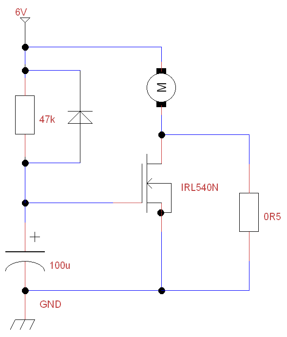

Here's a simple soft start I designed awhile ago. It enables me to run a 6V motor off a 5V SMPs, I tweaked up to 6V, without tripping the current limit.

Hero999:
Brilliant design!
It shows that one does not require a complex microcontroller or fancy analog circuit to achieve its purpose.
linear... you could do a rudimentary PWM with one opamp as an oscilator and another comparing the oscilator capacitor to your RC to give you the slow startup with out the dissipation.
There are a lot of options to choose from depending on how picky you are and how much power the motor actually uses since that will determine how simple it can be.
Dan
It can handle any load with suitable power resistors.
60 years ago, before the advent of power semiconductors, if one had to start a 250HP, 600VDC motor, one would use huge resistors in series with the armature. As the motor picked up speed, one by one of the resistors would be shorted out with a contactor, until the full voltage was applied to the armature.
The key here is that the resistors would have to survive the inrush current for only a few seconds. The resistors were made with heavy nichrome wire suspended on ceramic insulators.
Today, soft starting is best achieved with a PWM circuit
