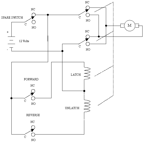

hi i have a 12v dc motor that pulls a cable, when the cable reaches one end, it hits a micro switch. Then reverses to the other end hits another micro switch and stops. Im using a double pole latching relay.
Hers my problem it dosnt reverse. I cant see whats wrong with my circuit
see attached pictures thanks in advance
What is the momentary switch for? The one on the right side of the diagram connected with green wires.
Most latching relays that I am aware of only need the coil voltage applies for a short time. Is this the way your latching relay is susposed to work?

i think its called a momentry switch its one that dosnt latch.
Yes the momentry switch makes a circiut through the normarly closed and common of the first micro switch, which is pressed in so it is now open making the motor stop.
Here is a diagram I think will work for you

thanks for your comennts the black lines on the relay are just to show wich way its latched but its al sorted now thanks
