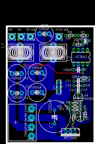

I just have a few questions. the designer of this circuit said that he went from about 60% efficiency to over 90% efficiency just by moving some wires around, and tweaking some component values. now, the values I am using are his "tweaked" values, but I'm trying to improve on the layout in any way I can. This is my current design. Anyone see any glaring issues that I should change in the layout to possibly get better efficiency?
(ignore the bottom capacitor overlapping things, the one I'm actually using is the same size as the rest of them, i just used that model in the layout because of the wider lead spacing to clear the trace going underneath)

I'm wondering what there is about the layout that has such a profound effect on efficiency.
