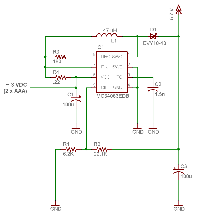

Hello everyone. I'm working on a project and have run into to some trouble. I'm hoping someone here can help me resolve it.
I'm building a prototype of a small, battery powered, motion sensor. I've made the PCB and have started soldering components onto it. I've gotten as far as the power supply portion of the circuit but it's not working correctly.
The power supply is a DC-DC boost converter based on the MC34063EDB IC. I'm powering it with 3V and need about 5.7V at the output. I've attached a schematic showing the portion of the circuit I've built so far and also, here is a datasheet for the MC34063EDB.
Ultimately, I want to power the circuit from 2 AAA batteries but when I tried that, it didn't output 5.7V; it output closer to 28V. After seeing this, I supplied the board with 3V from my bench power supply just to see what would happen and when I did, the circuit seemed to work fine. I measured 5.68V at the output.
Next, with the circuit still powered from my bench power supply I measured the current being drawn by the circuit and was surprised to see about 285 mA. I didn't look at it through an oscilloscope and my multimeter is not of the best quality so I'm not sure how close to reality the number is but it still seems surprisingly high to me. I mean there isn't even a load hooked up to it yet.
What I think is happening is when the circuit is hooked up to the AAA batteries, it is drawing more current than they can supply. As a result, their combined voltage drops to around 1.5V (which I've measured) and that undervolts the IC. The IC stops working, the battery voltage rebounds, the IC turns on again, the battery voltage drops, and so on. I think this astable operation is causing the higher than intended output voltage. Conversely, when I power the circuit from my bench supply, it has no problem giving 285 mA at 3V and the IC works normally.
So my question is this; why is the circuit drawing that much current? Shouldn't it be much much less especially since there is no load connected to the output yet? 285 mA seems like a ridiculously high quiescent current consumption. What can I do to reduce the current? Can I use a larger inductor? A different diode? Does anyone have any ideas?
Thanks in advance for your help.

If you feedback is broken you will get very high voltage out (28v) and too much current draw. Check R1, R2 and the connection Pin-5. Pin-5 should be 1.2 volts. R2 might be open or too large. R1 could be too low. Pin-5 could be open.

Thanks for your reply. I verified all the connections before posting this thread and they appear to be fine. Besides, if there was a problem with the pin 5, R1, or R2, I'd expect the circuit to exhibit the same unintended behavior regardless of whether it was powered by the AAA batteries or my bench power supply. However, it works fine when powered with 3V from by bench supply. It only doesn't work when powered by the 2 AAA batteries. Ideas?
Inductor looks kinda smallesh, 150uH better at those lower frequencies, but the main problem is that the ic chip is not made to work at under 3v. Not sure where you got the idea it should work with two AA batteries, or did you mean three? Two AA's will load down right away to under 3v and even if not it wont take long anyway.

Thanks for the reply. I'll try a larger inductor. I have a few 180 µH inductors that take up roughly the same footprint. As far as the other point you made no, I did not mean to say 3 AAA batteries. I understand the datasheet says the IC is designed to work between 3-40V but I have had success in the past at getting it to work at a lower voltage. I've tested it down to 2.4V before the output became unstable. Not sure what detrimental effect this might have but it worked in a few past applications for me. I was hoping it would work here too. The only thing I changed between this build and past builds was the inductor size. At any rate your Zetex suggestion is intriguing. Can you recommend a part number?

For this project, the circuit will have a peak demand of about 80 mA.
I have gotten this chip to work in the past on 2 AA batteries. This is my first attempt at using AAA batteries. Some time ago just to see how low I could go, I hooked a similar MC34063 circuit up to my bench power supply and monitored the converter's output while varying the bench power supply voltage. I was able to get the bench power supply down to 2.4V before the converter's output started going wonky. I don't remember how much load was on the circuit when I did this test. The only thing I changed between this build and prior ones was the inductor size. In the past I have used 180µH inductors. This time I'm using a 47 µH one.
I just got home and swapped out the 47µH inductor for a 180µH one and it works! At least it works so far without it supplying any load. I'll start soldering in the rest of the circuit now and see what happens. When I first switch it on there is some in rush current which I think is slightly undervolting the batteries. The output voltage starts at around 20V but within a second, everything stabilizes and I get a nice steady 5.68V. Not ideal I know but this project is only a proof of concept prototype so it should work well enough for that purpose. Do you think I could place an inductor between the positive terminal of the battery and the circuit's input to limit the in rush? For the next project using similar power sources and voltage levels, I'm going to try one of those Zetex chip as an alternative. Thanks for the help!

Boost converters are notorious for drawing high peak currents: a typical solution is to put a large value (low ESR) switching capacitor near the VCC pin of the IC so it can draw peak current from the cap and not the source. 100uF is not enough, try as much as will fit and make SURE it is a low ESR switcher cap (aluminum or tantalum).

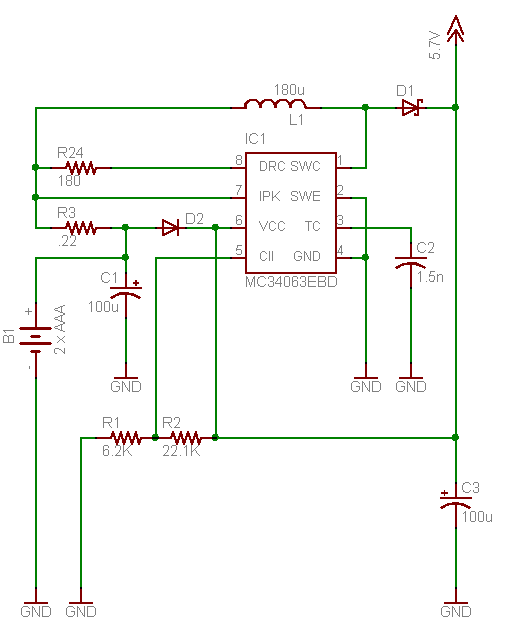

Hi Bountyhunter, thanks for the reply. For this to help reduce the peak startup current, wouldn't the cap have to be connected to the batteries all the time? Even with the power switch off?
mc34063-bootstrapped-png.58945

Do you have any thoughts on the boot strapping idea? I have a couple DIP 34063s. If I have time tonight I'll test it out. It may just be another case of me trying to get too much out of the little guy.
What do you think?

The high value inductor is likely working because of its extra wire resistance. It also limits the coil charge current for given drive frequency. Too much inductance for given chop frequency may prevent you from getting maximum output current needed.
With a 0.22 ohm current limiting resistor you will draw 1.4 amps peak during startup which, along with 47 uh inductor saturation, is likely causing the battery voltage collapse. Your peak running coil current necessary for 80 mA at 5.7 vdc output with 3vdc input will be about 500 mA so you should be able to raise the 0.22 ohm up to about 0.47 ohms which will limit the startup surge to 650 mA peak. This may help you get through the startup surge without too much current draw from battery.
If you saturate the coil during startup it makes the input current surge shoot up. The saturate current rating for the 47 uH inductor is 480 mA which is usually spec'd at point where inductance drops to 80% (38 uH) of original low current value. With a 0.22 ohm current limit resistor you are banging the coil into pretty deep saturation at startup surge.

I changed the inductor to a 180µH one (part number above). Also, I was under the impression the .22Ω resistor was for current sensing by the IC. Do you think it's OK to change it to .47Ω?
3. The fact that the initial voltage is above 6v is a danger-point.
You said The output voltage starts at around 20V but within a second, everything stabilizes and I get a nice steady 5.68V
The circuit can "lock-up" when the voltage of the supply drops and this can either drain the cells completely or produce very high output voltages.
Your best choice is to use a 3.6v cell It has twice the energy-density of AAA cells and comes in rechargeable. Or even 3 x AAA cells
