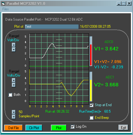

hi RJ,
This is a screen shot of my MCP3202 program, its written in Visual Basic5.
Using the PC, with the interface dwg I posted.
If you want a copy, I will post it.
Its written for my own use, but I will tidy it up a little and add some comments.
I also have a MCP3204 version.
You can edit or use it in anyway you wish.:)

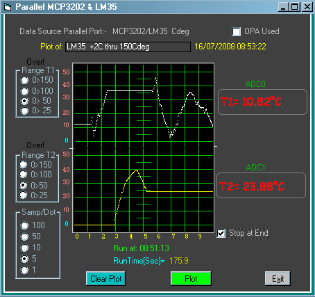

hi RJ,
Another PC logging example, LM35 temperature sensors with MCP3202 SPI into the parallel port.

I have just revised the MCP3204 parallel program using VB5.
You are welcome to a copy of the working 'beta' version, you will need to change the program to work with a RS232 input.
PM your email address.:)
