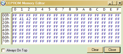

Can anyone see why this data EEPROM routine doesn't work?, it's driving me mad :D
I'm using a 16F648a, and I've used the same routine on the 16F628 in the past.

hi Nigel,
Set the EE_Address at 0x7F, the shared Banking, if its in the lower Bank0 is dosn't work, at 0x7F it writes OK.

What bank is the GP RAM register labeled EE_Address in? If it's in Bank 0 it will not pull the address stored in that register into EEADR while you're in bank 1.
Also, interrupts should not be enabled until after the write is complete. You can still poll the EEIF without the interrupts being enabled.
On my write routine I usually poll EECON1,WR instead of PIR1,EEIF so that I don't have to switch banks until the write is complete (EECON1,WR gets cleared by the hardware once the write is complete). Then I clear EECON1,WREN, switch banks, then clear PIR1,EEIF. Also, I get the address and data written to EEADR and EEDATA prior to calling the write routine.

I already do that, it's actually for storing the phone number to call, but it needs to be able to be updated via a text message - the original number (programmed in) works fine, but the update routine doesn't alter it at all, and in fact doesn't alter ANY of the 256 EEPROM locations, which I presume eliminates the GPR bank problem? (but I'll still give it a try tonight).
