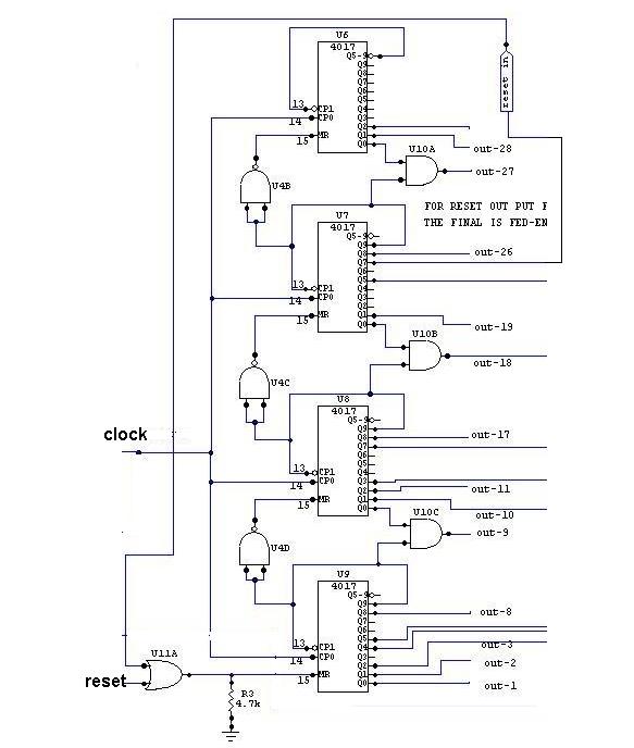

Trying to recreate the "cyclone" game you find in arcades using: 32 LEDs, 4 - 4017 decade counters, and a 555. The circuit is currently wired in a way that, when powered, there are 4 lights traveling around the 32 LEDs arranged in a circle, but I originally had wanted it designed so that only one light travels around the circle, and have been failing miserably at achieving this. I was additionally confused as to how to wire the circuit so that when the "player" lands on a particular color light, there would be a counter that would count up the points (3 for landing on red, 1 for yellow, 1 for green). Any suggestions would be greatly appreciated, I've been attempting this for days!!!. Thank You!
i think you are in need of cascading 4017s to make a single light to run around.
see the attachment for how to do it.

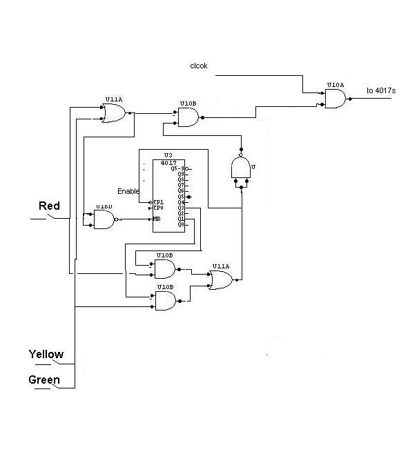

you have to count the clock pulses using another two 4017 ( one for red and another for yellow & green) and hold it when it finish the counting as required. so the driver 4017s will clock to the same and increment. if you need i may post a diagram shortly
Edit: attached a count & hold circuit

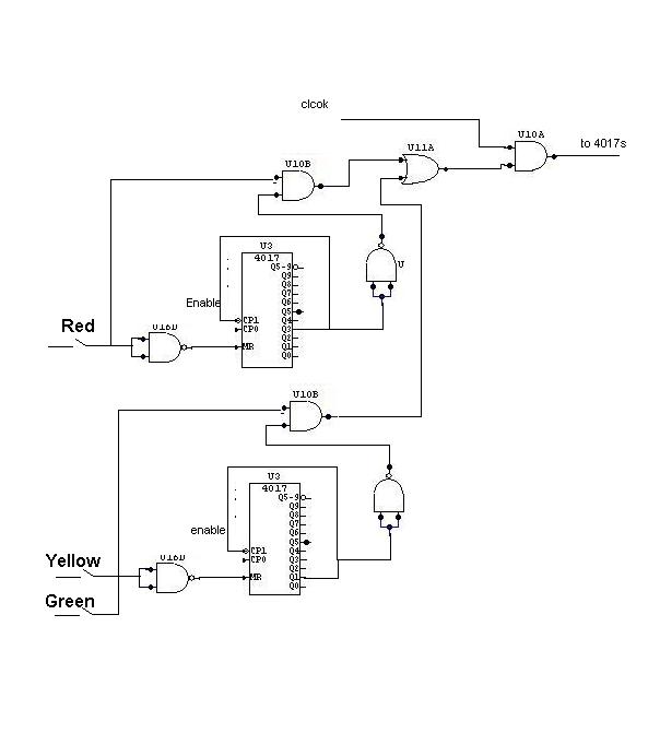

Edit: you even can eliminate one 4017 in my post and simplify it...
Edit: simplified circuit attached

Thank you so much for your responses!, just had a couple more questions. Can you explain to me how the count and hold circuit works because I guess what I had in mind (which I may have not been so clear about) was a circuit that would be able to register how many points you get based on what color light the player lands on when they hit the "stop switch".
i posted a modified one also... when any light is landed then the signal will enable the counter...reset goes low..
so it will increment until 1 count or 3 count based on what colour is selected...then hold until input is reset or until next hit
